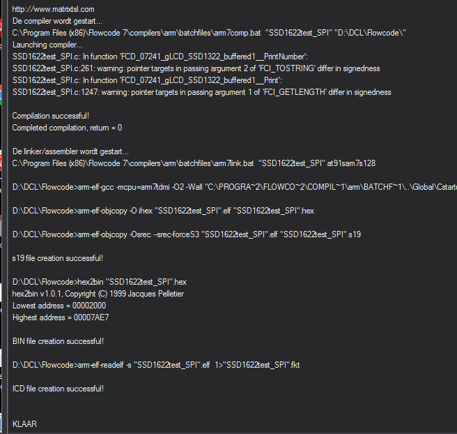

i tried a simpler led on off 1 second file and i got it uploaded in the processor hoping its the same structure but nope... no blinking led...
Beeing dissapointed i figured i get the ARM update package for FC7. wrong.. i cannot get or find the update. apperently i need to buy FC8 upgrade for 200 plus so i can add the ARM package.. or am i wrong?
What can i do?
please advice.
im affraid i have to eventually shell out 300 euro or so to get a 18 euro display on a 25 euro demoboard working
What can i do?
Someone have the ARM package for FC7 and can send me a bin or hex file so i can confirm my processor works?

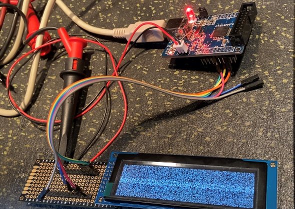

why my program by jtag-ice is not working il learn later. I got it working now via the bootloader and mloader and the led test in the bootloader works. got a simple prog with single led flash 1 sec off and on at A0 working by mloader so was up for the big test.... the display.
Have all hooked on and checked loaded and..... nope. same...
I did put the led flash in the loop too and that works.. the display initializes apparently but I feel its still not doing that correct. during the loop nothing changes and also during reset the display keeps the same noise. only a brief screen off at the point of the initialization in the loop and same noise back.
what can I do? both my displays do the same...

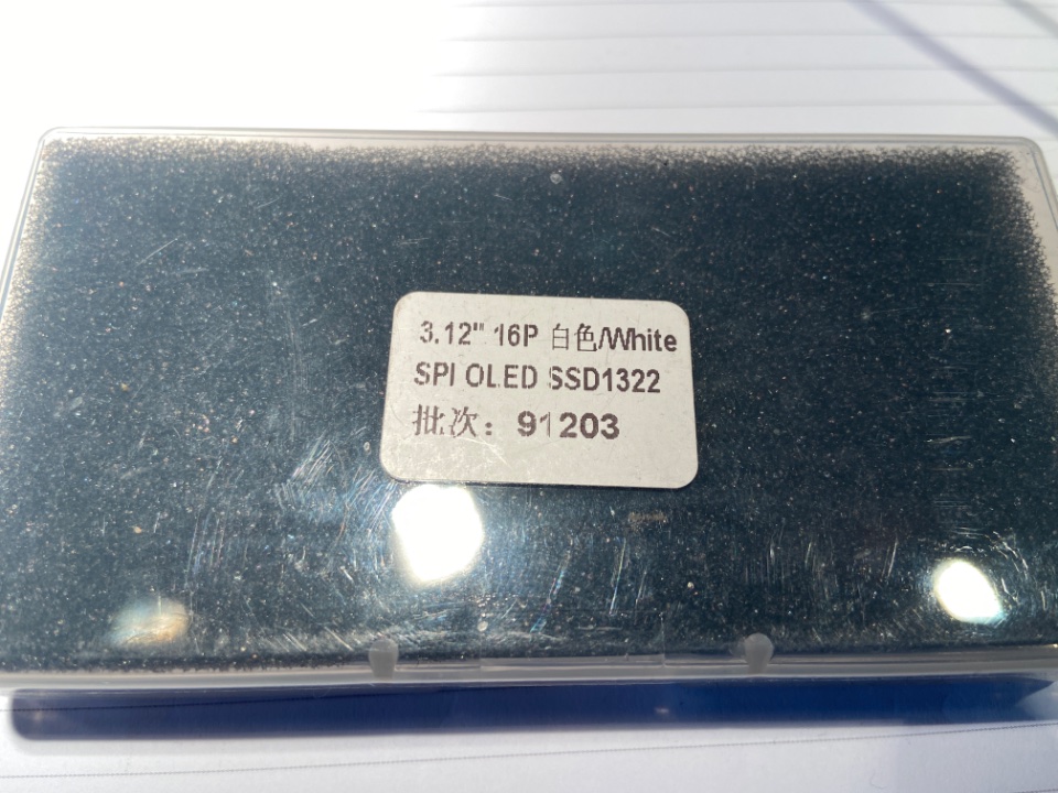

It looks like the SSD1622 display is not compatible with the SSD1322 code. It has a larger pixel dimensions and so there are likely a fair few differences in the driver IC.

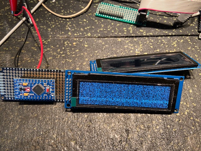

Re: SSD1322 macro crashes FC7 test
I gave it the wrong number ... it’s a SSD 1322
Il go try to make it work with an arduino sketch and theyr bootloader (never have done that) because that i have seen that working. Just to check my display.
