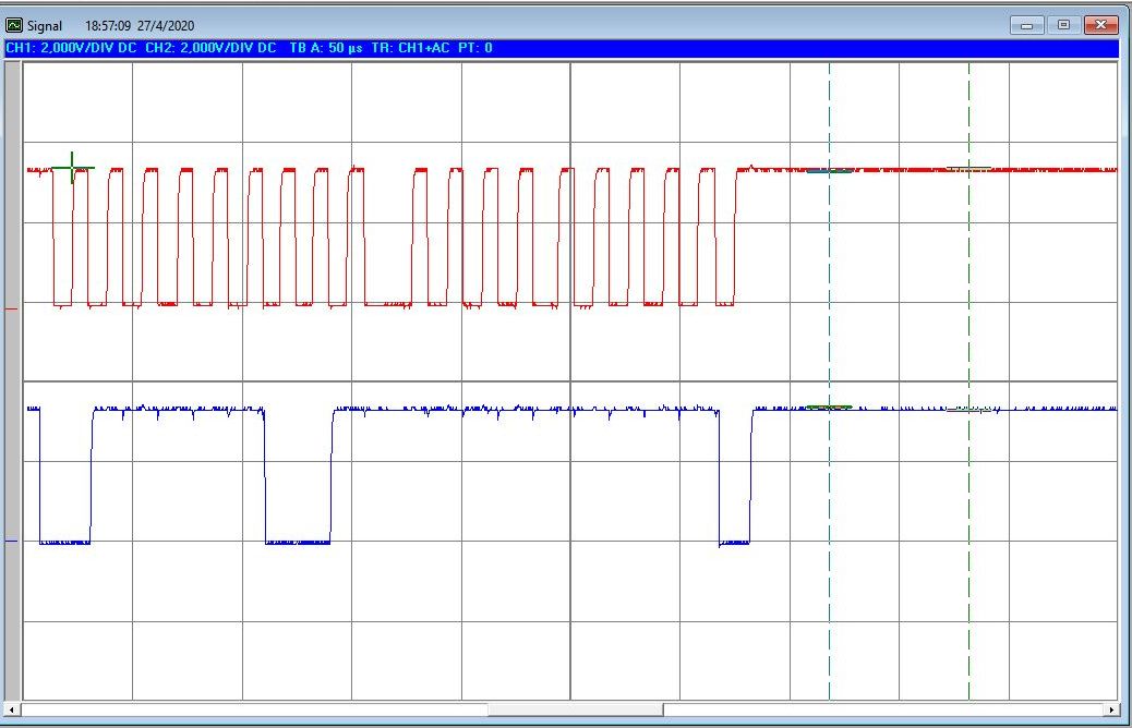

I checked again the SCL and SDA with the scope, more carefully this time, and I noticed two curious things:
a) On the SDA, there is a very hard debounce on the trailing edge of each pulse.
b) The START condition occurs a little bit after the first transition of SCL, i.e. the SDA signal falls from HI to LO when the SCL is in LO state.
I will try to post a capture from the scope screen.

I also realized a very strange thing!
The debounce was simply a very small transition at +5V!
The rest of the pulses are simply... 0-2V transitions!
The micros are working with 5V VDD on both boards.

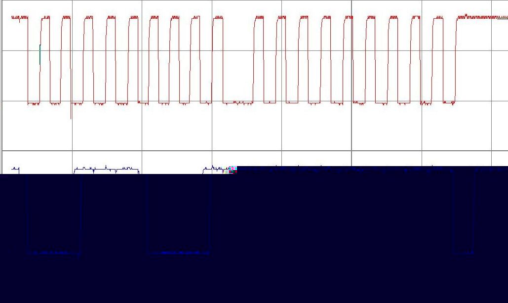

Here is a screenshot of SCL and SDA
Best Regards FOTIS ANAGNOSTOU

Doesn't look quite right even on the clock - for example 2nd clock (even with stretching) seems to be lower than other pulses and rather uneven. What pull-ups are you using? How long are interconnects too?

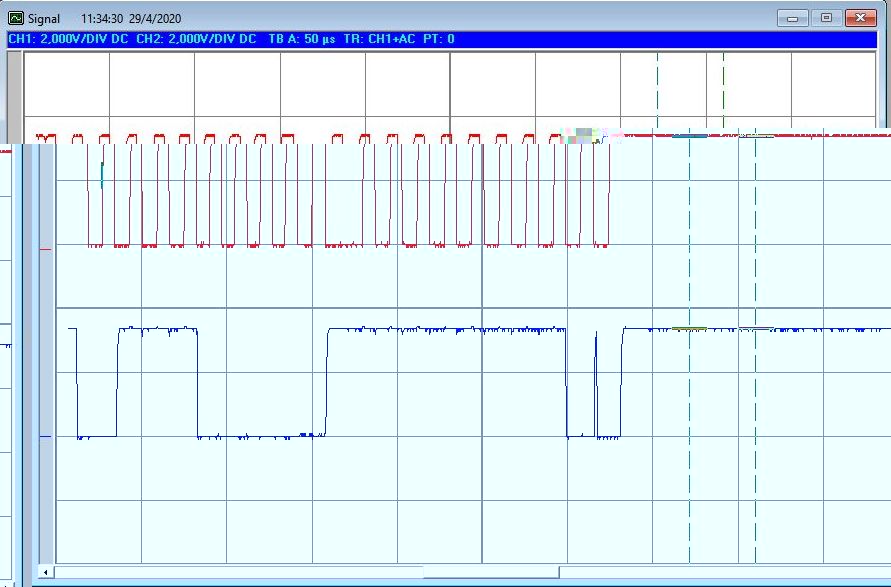

Here is a better screenshot showing all ten SCL transitions.

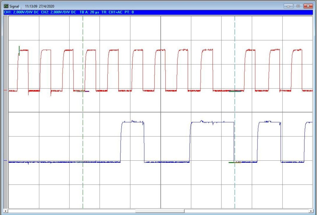

Here is a screenshot showing the I2C activity of my actual board with the STM32 configured as master and the Particle Argon as slave.
The FC code of master is almost the same as in the previous example with the P16F1937.
Both signals are much more clear. Simply the Argon doesn't respond. Could you see any ACK?
However, the Argon responds occasionally with ACK but in wrong address. I can see that in the Serial Monitor.

To get a better screenshot, I selected purposively as i2c slave address = 0x7C (0111 1100) and as data = 0xFF and bypassed the decision "If ACK=0 then transmit data, i.e. the STM32 transmits continuously the slave address and data. Here the pic:
I think the functionality is correct from the FC7 and STM32 side. The START condition is correct (SDA HI->LO when SCL=HI), 1st clock transition-> Address=0, 2nd=1, 3rd=1, 4th=1, 5th=1, 6th=1, 7th=0, 8th=0 (for the 9th clock pulse i think the SDA=HI and normally this might be the ACK=0).
Then it follows the Data 0xFF, SDA=HI for all of the SCL 9 transitions, and then STOP. Although the waveforms are very clear, I couldn't locate the two ACK.

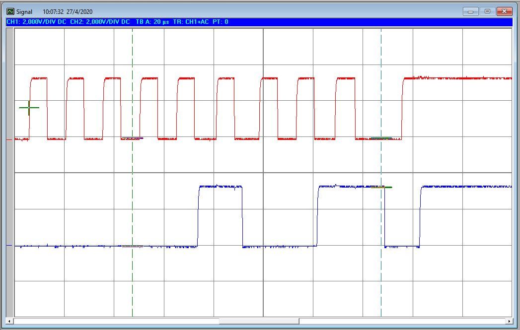

Please note that when the SCL is HI, any SDA HI->LO transition is recognized as START and any LO->HI as STOP. When the SCL is LO, any SDA HI or LO state is recognized as Data, or Address, or Read, or Write, or ACK, or NACK bit.
I also noticed on the Arduino I2C_Scanner plot, that the SCL pulses are... 10 per each I2C transaction from START to STOP, while in my plots are 9.
Please see this new screenshot where I selected Address = 0x38 (to make a comparison with Arduino plot) and Data = 0xFF

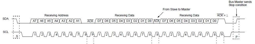

6-7 years ago, using the FC5 I had obtained a successful I2C master code for a P16F1939 managing an S/PDIF transceiver and a DAC of Wolfson.
I looked again at this code and the datasheets of WM8805 and WM8741.
For example, the WM8805 has two possible I2C device addresses: 0111 010x or 0111 011x
According to the instructions, for Device ID+Write the master should transmit 0x74 (0111 0100) and for Read 0x75 (0111 0101).
In my code at the time, I had used for Write: Device ID AND 0x7E. For Read I used: Device ID OR 0x01.
I couldn't see the Device ID Left shifted by 1, simply it is an 7-bit address with the LSB placed either to 1 or to 0 according to the instance.
However, in all of the screenshots of my scope, it seems that the slave address (ID) is indeed left-shifted by 1!
The same applies to your Arduino IDE plot!
