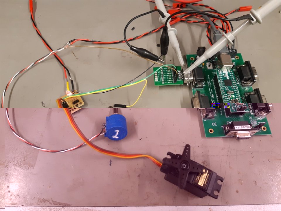

Interestingly, to induce the instability, I need to use the Pot to sweep the position value about. Sometimes I have to work the input quite a bit to upset it. Sometimes the I only get the odd glitch, other times I can get it to permanently glitch and oscillate the servo.
Sweeping around the 1.2mS pulse seems to regularly upset it, at least it feels that way.
With this glitch, If I stay in a single position value, thus fixed Pulse width, it seems perfectly stable.
I've kept my test setup as simple as possible to eliminate other influences. :) As before using a dual lab supply (with ground link) so that the servo 5V transient demands does not brown out the micro.
Servo_Test_Hardware (Medium).jpg (133.76 KiB) Viewed 11626 times
