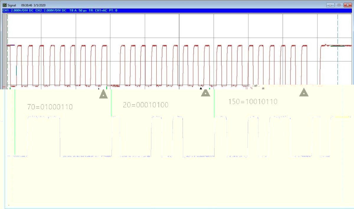

Can you look at the data on the scope - one end is getting it wrong. But is it send, receive (or both)?

I got a new screenshot of the scope. Everything looks OK. From the left, the first byte is the Slave ID = 0x38<<1 = 0x70, the second byte is the DataH=20d, and the third byte is the DataL=150d. The black triangles point the 9th bit=ACK. Additionally, I use 2 blue LEDs mounted on the STM32 application board, to show if the ACK is received each time by the master and both are ON. This time I added in the FCF two extra calculations to set again the ACK=1 after each ACK=0 at the end of each byte transmission.
However, the Argon still receives correctly only the last Data byte transmitted (i.e. 150) while the first Data byte is shown on Serial Monitor as 255d.

Hi Martin
OK, solved.
The error was in the expression while(1 < Wire.available()) { // loop through all but the last
It might be while(2 < Wire.available()) { // loop through all but the last to receive two bytes :lol: :lol:
So, I suppose for 3 bytes it should be 3 and so on.
A big thank to you again
Best Regards FOTIS ANAGNOSTOU
