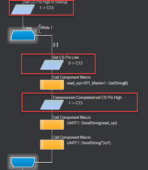

Hi.
For a start when you select Auto CS to "NO"(as you did in your FC chart)
Then you have to control the CS pin yourself in the Flowchart and normally SPI chips need to see a transition from High ---> low to start transmission
as I show you here with your C13 pin, which I assume you use for CS ,if you select auto CS and define the pin the component will do this all automatically for you
Secondly are you sure your controller is running at the correct speed? I looked at your Config settings and they seems strange to me
