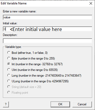

The Calculation box with
value = 1234
can also be deleted as was for testing only.
Although I would strongly recommend either use the calculation box to assign an initial value.
Alternatively, delete the
value = 1234
as suggested.
Edit value variable, then assign an initial value:
Reason for this is in Flowcode simulator, variables start of with an initial value of 0.
On your hardware, it will be some random value.
General rule of thumb:
If a variable is read first then it must have an initial value assigned.
If a variable is wrote first then an initial value is not required.
