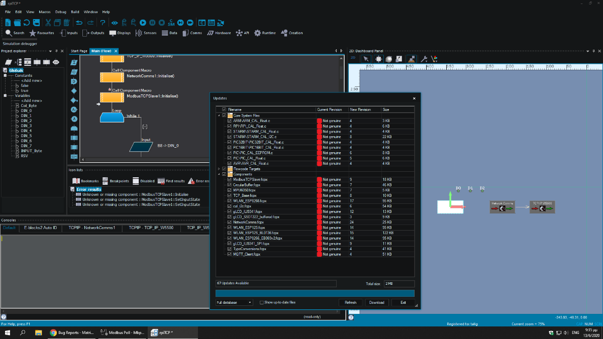

Problem with latest update
after I updated through the online updater service, the updated files and components current revision "not genuine".
Also the modbusTCP slave component disappeared from the comms tab and is not function anymore in my project.
I did a clean install of flowcode and the problem remains.
George
George
- Untitled.png (210.56 KiB) Viewed 8985 times

Re: Problem with latest update
Hi George,
While waiting for the bug to be fixed, there is a workaround.
Take a look at this post & apply it to your target device.
Hi Martin I already did that. It did not work.
Then I went ahead and reinstall with the installer I downloaded from inside my account. Problem remains.
The public installer download page does not work, returns an error when trying to download.
George
George
Thanks for letting us know. There was a big move over the weekend and it looks like some things are still missing.
Please bear with us while we correct anything, and also let us know if you find anything else wrong.
Regards,
Steve.

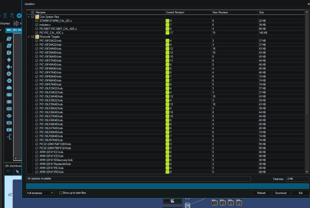

Hello
I have a different problem.
instead of the writing NOT GENUINE it seems that it has more updated versions than those present online!
- UpdateIssue.jpg (114.11 KiB) Viewed 8906 times
H Steve,
After a couple of reinstallations I have the same problem.
I also noticed that the modbusTCP slave component update was removed (it was actually making the component completely disappear from flowcode after updating).
Reverting back to previous versions does not work.
In any case modbus tcp and network component is not working any more neither on simulation or hardware. And there is no way I can revert.
I guess the only way around at the moment is to reinstall again and downgrade the component version( didn't try it yet but will do) as a workaround until the problem is fixed.
Please install a fresh copy of flowcode and do the full database update and you will see the results by yourself.
George
George
We're close to solving the issue. At the moment, the updater system is working, but any file downloaded from the online database is incorrectly flagged as "not genuine". The files should be ok once loaded. And we should get a fix for these downloads soon (so they show as "genuine").
Hi all
I have problems with the last revision (18) of PIC_CAL_ADC.c: not genuine
thanks
Bruno
thanks
Bruno
Thanks Bruno, Think it's something I've done, looking into it now.
