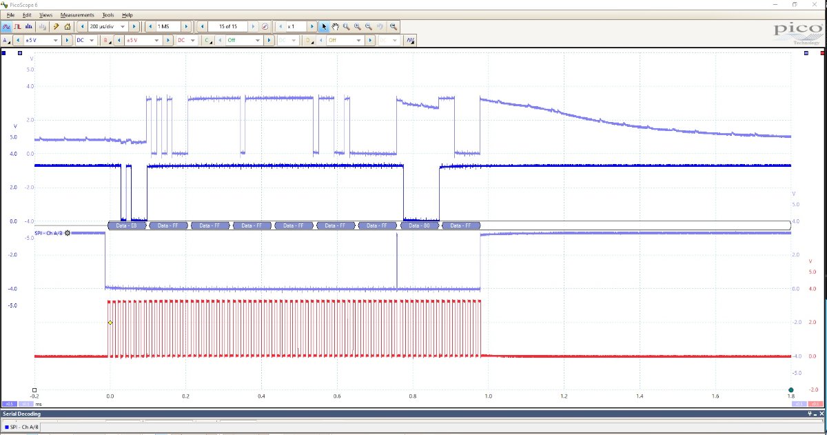

I also seem to be having reading the data from the Gyro, I get data on the bus but nothing seems to be saved into a variable. I have attached a trace of the SPI bus for you to take a look at.
**EDIT - I now seem to be reading data (by taking the DEN pin low), but seems values seem to be random**
Any idea where I am going wrong?

Hmm I wonder if the two components have a different SPI mode, there are generally 4 modes involving the state and sequence of clock and the data but generally two of the 4 modes will work on any one slave device.
As for what's causing the lockup if you could find out the specific component macro call that is doing this then I can investigate for you. I don't think it will be the low level SPI code though there is a while loop here in the send function this hopefully shouldn't cause any problems. It could instead be something higher up that isn't getting the value it wants and therefore staying in a loop.
