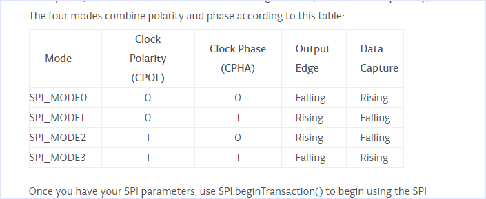

Hi, using the SPI master function for programming an Arduino / ATMEGA328P, we would like to setup the SPI mode and Bitorder.
In the SPI Master component found no settings for this, and copying the C-code from a arduino.INO file does not work because of missing SPI.library....
Like to set these 2 parameters:
SPI.setDataMode(SPI_MODE3);// When SCK is high, send/receive data, when idle, set pin to HIGH
SPI.setBitOrder(MSBFIRST);// Transmission from MSB
How can we do that?

The bit order for the SPI Master is MSB first.
The MODE settings are in the Component Properties ...

Many thanks LeighM,
with this knowledge now i can cross these settings to the corresponding SPI Modes!
