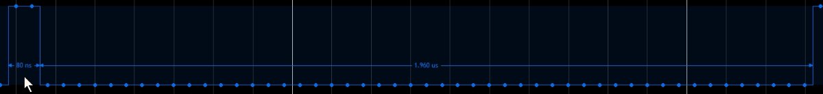

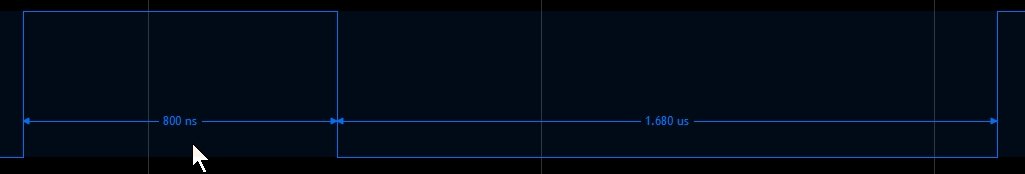

Hey Guys,
I like to hook up in this discussion with my little problem.
I'm using the WS2812B on a PIC16F18857 MCU with use of the internal oscillator running on 32MHz.
Using the WS1811 macro does not work in this setup. When running the compiler the first message is:
(1273) Omniscient Code Generation not available in Free mode (warning)
V1.0_20200704.c:
270: #warning WS2811 Timings are less than 10 instructions, timing may be incorrect at the current clock speed
^ (162) #warning: WS2811 Timings are less than 10 instructions, timing may be incorrect at the current clock speed (warning)
Checking with a probe at the MOSI pin gives now data..
The compiler does finish and the project is running fine except for the WS2812B..

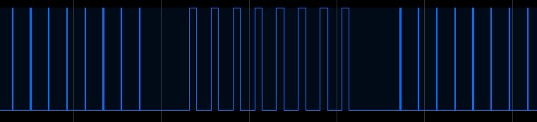

Re: WS2812B compilation problems.
Do you have access to a scope so you can see the specific timings the chip is outputting?
Might be worth setting the LED type to custom and playing with the timings. Maybe try reducing one of the various timings by 50% and seeing if that makes any difference, then repeat for other timings.
Let us know how you're getting on.
Hi Ben,
Yes, tested with a scope but no data.
Made a test project with a different MCU.
Also no Scope data and still the warning message from the compiler.
Tested all LED_Controller variables.
Employing 18F4550 errata work-arounds:
* Corrupted fast interrupt shadow registers
Test WS2812B.c:
136: #warning WS2811 Timings are less than 10 instructions, timing may be incorrect at the current clock speed
Regards,
patrick
Test WS2812B.c:

I am doing tests with a RGB WX2812B and an ECIO40. The test programs work, but the signals at the oscilloscope do not match at all.
Here is a statement for a ring of 8 LEDs all lit in red (G = 0, R = 255, B = 0). Everything seems correct but here are the measurements for the low states: T0H = 80ns, T0L = 1960ns and for the high state: T0H = 840ns, T0L = 1640ns.
The times are not at all in accordance with the datasheet but it works!
At compilation, I have the same message as above:
