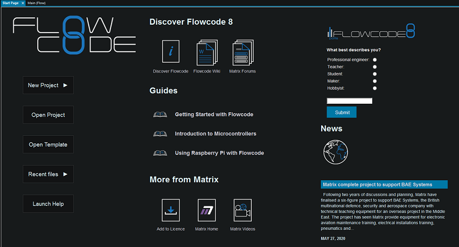

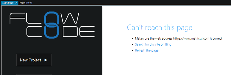

Have you tried disabling firewall, than try again with Flowcode V8?
Also when you run V8, if it connects OK with server, on the start page you will see: If does not, you will see: So not worth entering licence details until you can see the top image on the Start Page of Flowcode.

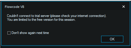

Hi Mr. Martin,
Well, I get the message below when I launch Flowcode, it seems weird.

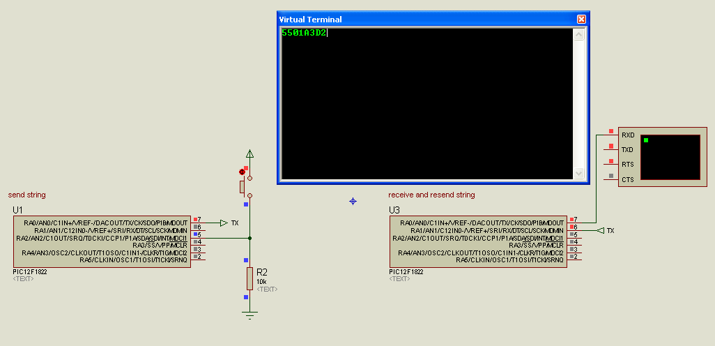

Hi Mr. Martin,
I'm pleasantly impressed, it works. Flowcharts are made in Flowcode 8.2.2. ? Which compiler did you use, the XC8 in Flowcode or the new version from Microchip?

Your're welcome & glad it works.
Created with Flowcode 8.2.2.15, using the default XC8 shipped with Flowcode.
