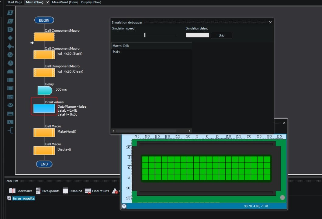

I've just downloaded Flowcode 8 on a 30 day trial.
Problem - I cannot see how to add variables to the simulation debugger window.
I do not have the 'Expression' and 'Value' tabs mentioned in the Flowcode help.
Please see attached screenshot
Any help gratefully received!
Clive
Cannot add variable to the Simulation Debugger window
- Flowcode8 screenshot.jpg (72.89 KiB) Viewed 2046 times

Re: Cannot add variable to the Simulation Debugger window
Hi Clive,
That's a strange problem that I've not seen before.
Does the same thing occur when Flowcode is closed and restarted? And how about if Windows is restarted?
Another thing to try is to change the language for Flowcode in the "application" screen of global options (you'll need to restart Flowcode each time). Try overriding the language as setting it as English first. If that doesn't work, try a different language. Does the problem persist in a different language?
If the problem does remain, you should try restarting Windows in "safe mode" and then running Flowcode to see if the problem is there then.
Please let me know if any of the above makes the screen show appropriately (or not). This might help track the source of the problem.
Steve.
Hi Steve
A Windows reboot and then re starting Flowcode has fixed it.
I should have thought of that myself.
Thanks for your help
Clive
