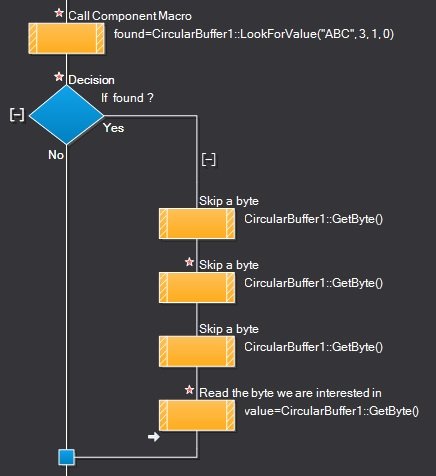

Would this do a similar thing for you.
The first icon removes content from the buffer until it finds the text "ABC"
Then we skip over the bytes were not interested in "987" and return the byte we want.
Then this would be left in the buffer "543210%%%%%%"
Otherwise what your suggesting sounds possible.

I saw this example already and I used it for another project, but thanks again!!
Appreciate it (like always)!
But can I conclude that after the search has a positive result, the "pointer" of the CB is right after the last byte of the search result?
Maybe this info can be put in the Wiki for this component?
This is something I wasn't sure of.
