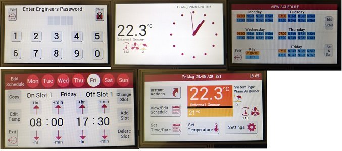

Using Flowcode I created a heating controller using FT810 for a 7in touch screen.
Lots of credit to Ben of course. :)
The touch function is so much easier than other type of controllers.
Reason is each graphic whether a shape or an image you can assign a tag number.
That the shape or image is touched then tag number can be detected.
The camera does not do attached images justice as the hardware scree is crisp and bright.
This are only some of the screens.
There are a fair few more.
Heating Controller FT810.jpg (134.99 KiB) Viewed 7675 times
FTDI also have software that will display the coordinates for the images, text etc.
Takes the guess work out.
