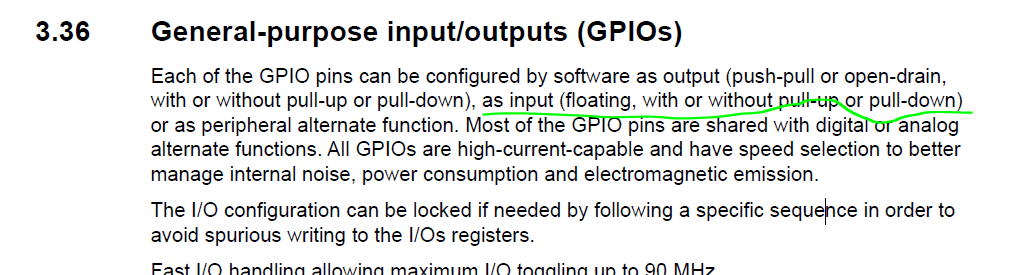

I need your help about , how to configure the ARM MCU's GPIO pin Input Pull up or Pull Down configuration through Flowcode. Below is the GPIO configuration details. One of our project, we need to make the GPIO(PC14) Input pin must be in Pull up mode to measure the signal. Can you please advice how to config this pull up mode GPIO input pin?
Below is the details from STM32F446ZCT6 datasheet page no 37.
"3.36 General-purpose input/outputs (GPIOs)
Each of the GPIO pins can be configured by software as output (push-pull or open-drain, with or without pull-up or pull-down), as input (floating, with or without pull-up or pull-down) or as peripheral alternate function. Most of the GPIO pins are shared with digital or analog alternate functions. All GPIOs are high-current-capable and have speed selection to better manage internal noise, power consumption and electromagnetic emission."

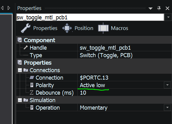

Also please advice Active High and Active low represent teh Switch Input corect. It is not related to GPIO Pull up and pull down correct? please advice.

Regarding your second question, no, the Active High/Low does not relate to the pull up/down.
The Active polarity determines the input voltage that sets the switch state to true.
And, due to the previous comments about the pull-ups, you would not be able to use the Switch component if you set the internal pull-ups via C code. (Using the component would turn them off again)
Best all round is to just add a resistor, if that is at all possible

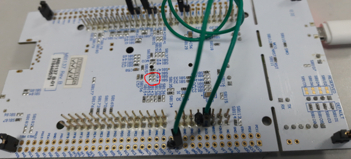

I'm using our own board and this step always shows low even PC14 port goes high thorugh other switch circuit in my board.
Even I have ST Nucleo board in my hand. I tested with Nucleo with the attached simple program in the same port configuration and it also measures "0" always. I pull down the PC14 pin to Gnd still the measurment is "0" and I pull up the PC14 pin to 3V and still the port status is "0".
Is there any issues with the PORTC in our flow code? please help to check.
Note: I have updated the Flowcode via Help -> Check for updates
Below are the pictures of our boards and Nucleo board and UART screen shot.

I think the issue is due to PC14 and 15 being related to the LSE.
I recall that on Nucleo boards some jumpers need changing to switch out the oscillator components.
If the input isn’t working on your board either, then it looks like some config is missing, but I’m not sure what yet.
None of this relates to the new C code, I suspect PC14 and 15 won’t work with standard Flowcode Input components or code either.
Unless you want to check that?

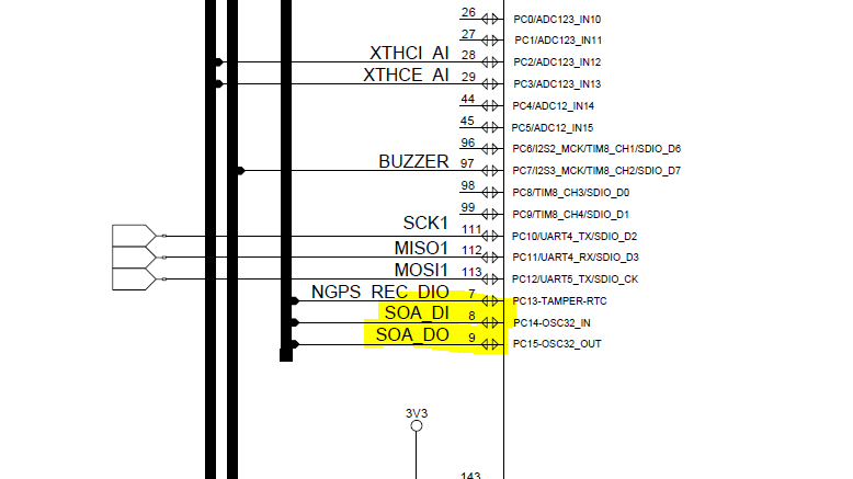

Yes. I understand that the Nucleo board has the crystal OSC on the PC14 and PC15. But on my board, this port (PC14) is used as DI (Digital Input). Can you please guide me to solve this issues?
Because currently I cannot sense the SOA_DI signal, because my board doesn't have the external pullup resistor on PC14

Yes, what I meant was that the pins PC14 and PC15 are not working properly as inputs because the 446 device uses them for the low speed clock.
It looks like this isn't fully disabled by default.
I'm still looking into how to fully disable the clock and setup the pins as inputs (i.e. all the register configurations required)
but have not yet found the solution.

Re: STM32F446ZCT6 GPIO Pin Pull up/down configuration
Hi LeighM,
Thanks for your great support always.
I'm really sorry to say this still PC14 is not working and status always read "0". Now I have try to test the PORTC13 (removed teh RTC OSC disable code) with your pull up C code and it is working fine. I have measured the voltage on PC13 port it measured around 2.77 VDC. It clearly shows that the internal Pull Up resistor is ON and your code "GPIOC->PUPDR |= ((1) << (13 * 2U));" is working fine with PC13.
But it doesn't work for the PC14 even after add your below code.
Karthick.

I tested the code on a Nucleo64 F446RE
On the board you have are there any links to change and components to remove to connect the header to PC14/15 instead of the oscillator?
edit: from the Nucleo 144 datasheet ...
LSE not used:
PC14 and PC15 are used as GPIOs instead of low-speed clock.
The configuration must be:
SB144 and SB145 ON
R37 and R38 removed
LSE not used:
SB144 and SB145 ON
R37 and R38 removed

Hi LeighM,
Yes. In my Nucleo-F446ZE board, SB144 is OFF and there is no any connection between the SB144 to CN11 pin 25. After I soldered the Short in SB144 now I can access the PC14 Port from CN11 and it is working fine. Even it works with just "GPIOC->PUPDR |= ((1) << (14 * 2U));" C code. No need to add the RTC OSC disable Code. It was my mistake and I didn't see this SB144 open in my Nucleo Board.
Now I have tested with My project board and it is working fine as I expected. I think no need RTC OSC disable code for my board too.
Thankyou very much for your kind help LeighM.
Karthick.
Karthick.
