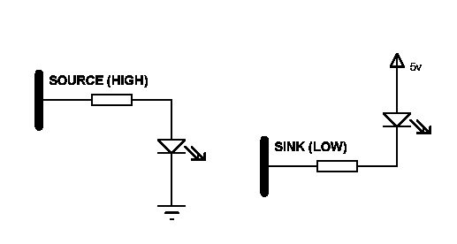

Jay Dee
Posts: 398
Joined: Tue Aug 18, 2009 6:42 pm
Has thanked: 121 times
Been thanked: 154 times
Re: Digital Outputs - On Off states
Post by Jay Dee »
Thanks Leigh,
Good to know.
And picture is worth a thousand words! :)
