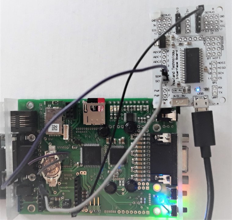

Posts: 654
Location: switzerland
Has thanked: 182 times
Been thanked: 179 times
Re: MPU9250 results are not stable
I connected your Interfaceboard to my hardware and read the temperatur from the MPU9250 . It is stable and correct all the time.
With my board (PIC32MZ and MPU9250) is reading the temperatur not stable.
With a demoboard PIC32MZ and a demoboard MPU9250 is reading the temperatur not stable.
But with your Interface and the demoboard MPU9250 reading the temperatur is stable and correct all the time.
On my board is a I2C RTCC and reading from there is always working fine.
