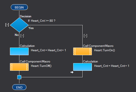

Is the counting ok in this way?
Do you have pullup resistor for the I2C bus?
With your oscilloscope did you see the clock and data you are sending?

I pulled up 4.7Kohm resistors on SDA, SCL.
And when viewed with an oscilloscope, the clock is not generated in SCL.
Heart count monitors MCU operation status. Heart count doesn't make sense here, but it works fine.

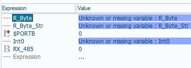

One more question.
FC8 shows warning.
I am not sure how important it is, but in case:
- what about missing variables in your program?
FC8 shows warning.

That would happen for three reasons.
1)Added assigned a new variable, added it to simulator debugger, then deleted variable from flowchart.
2) Renamed a variable.
3) Added a local variable and no longer within the macro where variable is used.
Its not whats happened in your case as missing variables were global.
