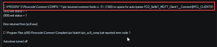

Just an interesting thing I notice when using the MOTT components with ESP Component
your example FC Chart compiles perfectly for all the bigger RAM values like the PIC182585,16F18877,16F18857 etc these chips has 2096 and 4096 RAM
the chips such as PIC16F1938,16F18855 with 1024 RAM the compiler reports some space errors
This is no problem for me at the moment as I am just learning but in future it would be good to know on what chip(memory /RAM size )this should be used

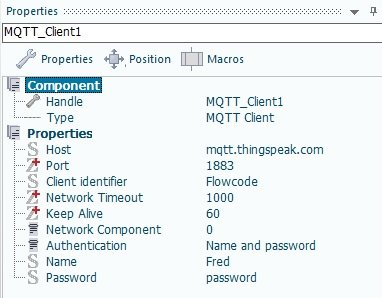

Hi Guys,
Adding a password to the broker in the RPI (as per your document Ben) publishing to the topic by the commnad window in the RPI works
However How do I add the password as a parameter to the publish component in FC
 mosquitto_pub -h localhost -t "test" -m "Sensor/Pot" -u "Fred" -P "password"
So the Topic in the RPI is now set for Sensor/pot and the client (in FC)publish to this topic with the following parameters
Topic set as "Sensor/Pot"
Payload as data(data contains the string of sensor info)
where do I add the example password "Fred" in this publish component parameters?
All help appreciated

Re: MQTT Basics and FC
I've added the following image to the wiki page to help clarify how it's done in Flowcode.
