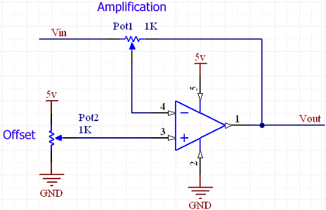

Re: Using FFT_test.fcfx
Hello! Ben
good evening
Because in my hardware once i disconnect the sensor probe i receive negative voltage (-0.5V) on the ADC pin, once i connect the sensor probe the reading is 0V, this is correct, but what if i want to detect the sensor probe is open, any trick.
Thank you.
Abhi
good evening
Kindly excuse to repeat, your post clearly mention, but absolutely no chance to recognize the negative voltage?
Thank you.
Abhi
Hi Abhi,
Any voltages less the minimum resolution E.g for 10 bit = 5/1024 = 4.88mv will be treated a 0
That will include negative voltages.
You will need to be careful with negative voltages as the clamping diodes will clamp the ADC pin to -0.7v
If current is not limited and voltage is lower than -0.7v then the microcontroller will be damaged.
What about trying this circuit?: From here
Hello!
No, there is no option to measure negative voltage via simple microcontrollers, without extra analogue components.
You can get negative results, if the controller have special ADC. Eg. PIC18FxxK80 family have differential ADC. The ADC module (optionally) have two inputs, positive and negative. If the voltage on the negative input is higher than the voltage on the positive input, the ADC will give you negative results, but both inputs're positive. Lots of external ADC chips have differential inputs, eg. ADS1115, MCP3550.
The input voltages must be within the limits, see the IC-s datasheet. This limit on the ...K80 family is -0.3 to 7.5 V, respect to VSS. If you want to measure negative voltage, you have to mirror it to the positive area, eg. with an inverting operational amplifier. The trap, if the opamp get positive input, the output will be negative. One solution is if you're using precision rectifier. In this case, both negative and positive input will give you positive output. Other solution is to measure negative and positive voltages is to add offset voltage to the voltage what you want to measure.
I don't know every microcontrollers, maybe some of them are can handle negative voltages but i'm not sure about this.
Edit: medelec35 was faster.
Hello! Martin
Many thanks for the explanation about the minimum resolution, to be honest i was not aware of that, something new to learn, i will check the link you provided.
Hello! Bachman
Thanks to you and Martin too for the suggestion about using the analog ckt, actually the present Op-Amp gadget what i am using works well when the loop is closed, i wanted to trip the output once the loop gets open, i think i will give a try with the chips you suggested, for the moment i am using PIC18F26K22.
Thank you again to both of you.
Abhi
Hello! Bachman
Abhi
