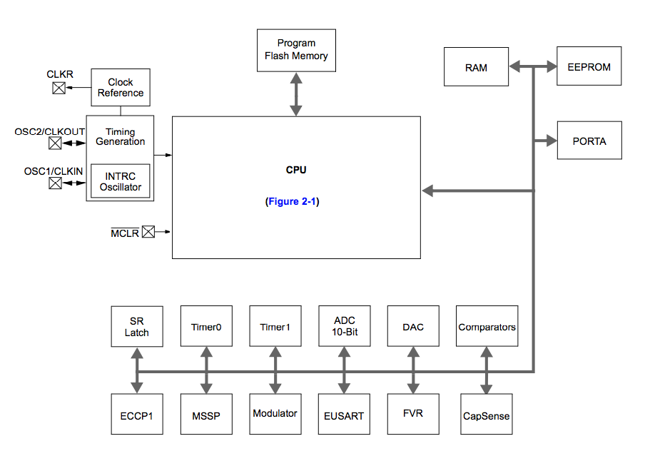

The RS232 (UART) module is a dedicated module, controlled by the CPU. The CPU "tells" to the UART module to send a character and continues executing the program. The CPU can handle the interrupt during UART data transfer while the UART module is still transmitting or receiving the data. Same results with other peripherials. Here is the block diagram of a relatively simple µC, PIC12F1840:
Edit:
Not all pheriperials shown on this picture, mistake in the datasheet.
