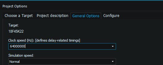

I've had trouble getting a graphics LCD ILI9341 to work on SPI.
I'm using a PIC18F45K22 with the internal RC Oscillator.
When I run the '1 second test' it is 8 x slow. i.e. 8 seconds up, 8 seconds down instead of 1 second up, 1 second down.
I have attached some screen shots.
What am I doing wrong?
Clive

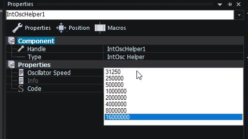

I never used this chip however I haven't seen a PIC18 that can run at 80Mhz the max I expects 64Mhz
I would guess that in the OSC Helper you select the Internal OSC speed as 16Mhz (click on the OSC parameter and a list box will open that shows the various speeds the Internal OSC can run at.
Then select 16MHz with your 4 times PLL enabled that = 64 Mhz also set the Clock frequency in the Flowcode Properties as 64MHz and try again do not forget to write the new OSC helper value for the OSCCON to the OSCCON regsiter with a C Icon
edit :Sorry just saw now chipfryer is correct I saw 1 zero to many
However 8Mhz with PLL enabled is not 8Mhz Clock ,that would be 32Mhz assuming the the PLL has an effect with Internal OSC something to check from the data sheet

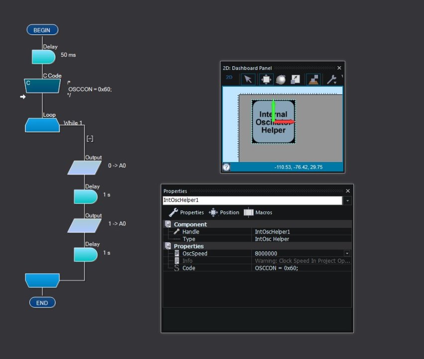

Looks like you have a "typo" in your C-Code block. You accidentally put your Osconn setting within the comment parameters.
In your C-Code block, just have :-
OSCONN=0x60;

I've spent some time 'playing' this afternoon and these are the results -
In all Tests below, The Oscillator Selection Bits (In the Configure tab) is set to "Internal Oscillator block, CLKOUT function on RA6, port function on RA7
TEST NO.1
In General Options - Clock Speed set to 64,000,000
In Configure - 4 x PLL Enable - Enabled
OSCCON not used in the flowchart
RESULTS - FAIL
1 sec on RA0 actually measures 64 seconds!
CLKOUT on RA6 = 250KHz
ie Internal oscillator running at 1MHz not 64MHz
TEST NO.2
In General Options - Clock Speed set to 16,000,000
RESULTS - FAIL
1 sec on RA0 actually measures 16 seconds
CLKOUT on RA6 = still 250KHz
TEST NO.3
OSCCON set to 0x70 (16MHz) in flowchart
RESULTS - PASS
1 sec on RA0 actually measures 1 second!
CLKOUT on RA6 = 4MHz
ie Internal oscillator running at 16MHz
TEST NO.4
In Configure - 4 x PLL Enable - Disabled
RESULTS - PASS
So the 4 x PLL option doesn't do anything?
Also the only way to get the internal oscillator to run at 16MHz is via the OSCCON command. Whatever you set in General options seems to be ignored?
I've ordered in some PIC18F47K40 chips to try to see if they perform the same.
Clive

Hi Clive,
For 64 MHz
Can you try setting internal clock speed to 64000000.
Then add C code block with
Also If display is not working,
Try setting SPI to software mode.
If that fails then try at 32MHz
For 64 MHz
OSCCON = 0x70;
st_bit(OSCTUNE,PLLEN);

Your'e welcome Clive.
It's my understanding that PLL in options is for crystal only and is for internal OSC only?
Re: Cannot configure Internal Oscillator
Hi Martin
Sory I've taken so long to get back to you!
That works - thanks for your help. Much appreciated.
