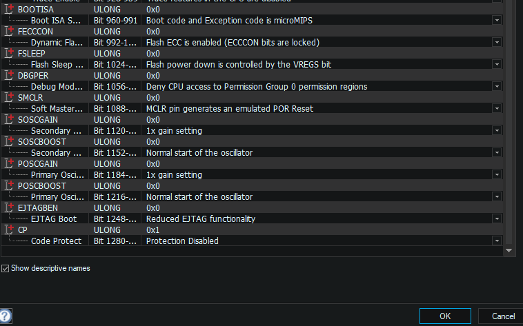

Just go to the:
Build/Project Options/
Then to the:
BOOTISA and change form
Bootcode and Exeption code is micromips
to
Bootcode and Exeption code is mips

Good spot!
Happy to confirm the interrupt is now functional.
Thank you for your help :D
