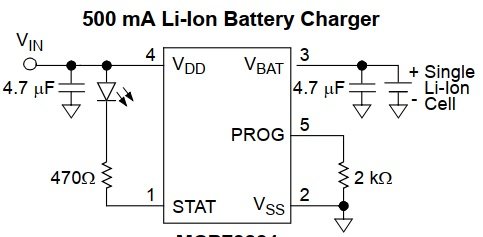

A bit off-topic, but i'm currently figuring out how to implement a Li-ion battery + BMS. If someone has tips & tricks on this subject, please feel free to share :)

For single cell batteries I've had good results with these, though I was using Li-Po type cells they should be compatible with both Li-ion and Li-Po.
https://uk.farnell.com/w/c/semiconducto ... rt=P_PRICE

@Benj @Steve001 Thanks for the reply, I decided to go for the MCP73832T and it's working like a charm :) Only thing is, the STAT led stays on after charging is done. But that may be because I'm testing with Li-Ion battery's that are over 8yrs old.
