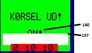

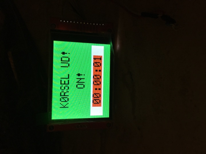

1. But sadly no. Picture ver10 ok But pictue V16 not good. Please have a look on the att. picture. And Ben there is also different problem with the

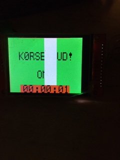

Hopefully the new version should be correct again in terms of the rectangle.
It looks like there is also an offset between the earlier version and the new version. Might be worth printing a line from 0,0 to 239, 319 and seeing where it starts and ends to see what is required here.

Wow you are fast. Ver. 17 better but not 100%

Re: Flowcode 9 Bugs!
Hmm so all the text is slightly off in terms of coordinates. Thats very odd. I can't see anything that might cause this in the code.
How does what you have now compare to the simulation?
