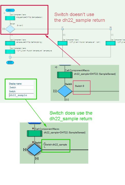

viktor_au

Re: atmega328p DHT22 problem
Post by viktor_au »
Hello kabouras
Please pay attention to switch.

Post by kabouras_33 »
By the way the dht22_sample variable is to return 1 for no data and 2 for crc error i believe so i dont see any reason why the switch does not work...but i did not need it so did not try...i will test it tomorrow though :mrgreen: :mrgreen:
