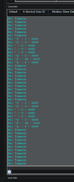

In simulation, I have taken a known working (on hardware and simulation) program and changed the macro’s from Modbus Slave to Modbus Slave USB. On the USB serial 1 console I Get mostly TX timeout, with occasional data revieved. There is nothing in the Modbus slave window.

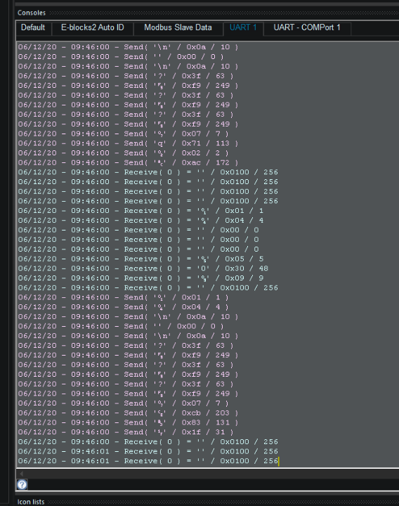

With the working program, in UART 1 I Get:-

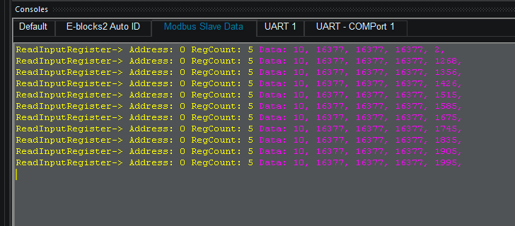

And In the Modbus slave window:-
There are no differences between the programs except changing the Modbus Slave macro's to Modbus Slave USB, i am not sure if there is more i need to do? The modbus master is running unchanged between the two
