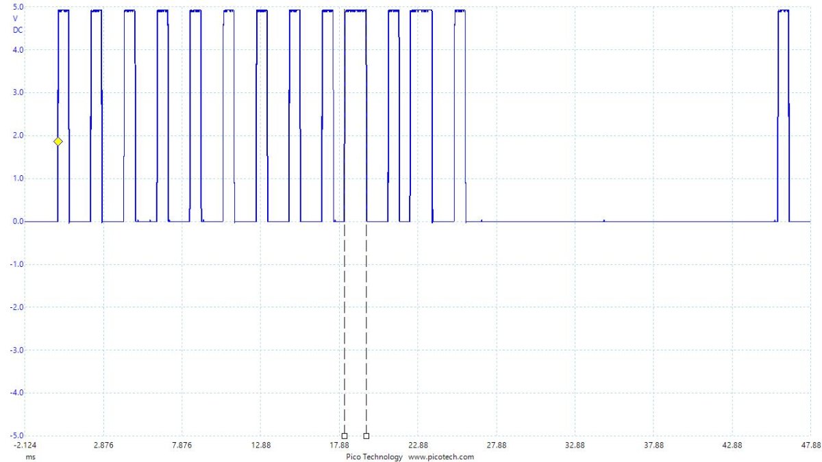

Has anyone have experience of emulating the UM3750 encoder/decoder, I am more interested in encoding as I want to transmit into an existing scantronic receiver. A google search shows an Arduino sketch so it has been done but I have no idea about interpreting it! I have controlled a UM3750 directly from a pic but it takes up 12 ports and it would be great to use just one for the data stream.
The timing looks simple enough, I am just not sure on how to structure it. Attached is a screen grab of an existing transmitter with bits 2 & 8 on.
thanks
Ian

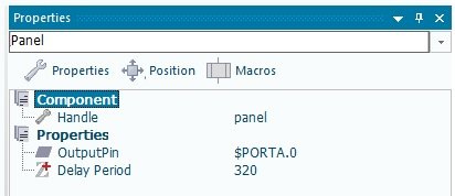

Struggling with this as I cannot see where in the properties to set the output pin to C1 and a delay of 700uS as just not seeing the option.
Using a variable to set the output code is as far as I have got, any pointers would be great help, thanks
Ian
UM3750_Transmit2.fcfx
(12.85 KiB) Downloaded 204 times
Re: UM3750 Emulation
I think you're after the properties window with Panel selected at the top.
ianjoh
Posts: 41
Joined: Tue Nov 13, 2018 11:53 am
Has thanked: 2 times
Post by ianjoh »
Thanks Ben, nowt like missing the obvious :oops:
