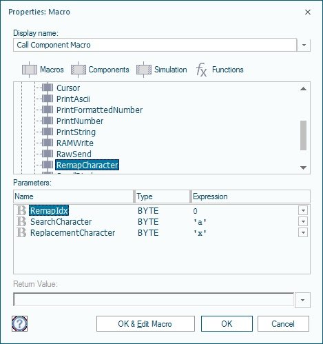

The LCD (Generic Configurable) component has a property called remap characters that allows you to take a character and automatically remap it to a different character when printing strings. I beleive this is what you need.
For example this macro would replace any occurance of the character 'a' with the character 'x'. You can also use hex or decimal values as parameters instead of characters.

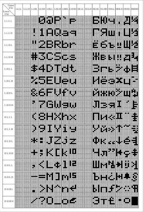

I do not have LCD (Generic Configurable), but there is a LCD I2C 4x20 on it does not work. Perhaps because I am using extended ASCII.
My table is extended ASCII
extended ASCII.jpg (210.4 KiB) Viewed 6017 times

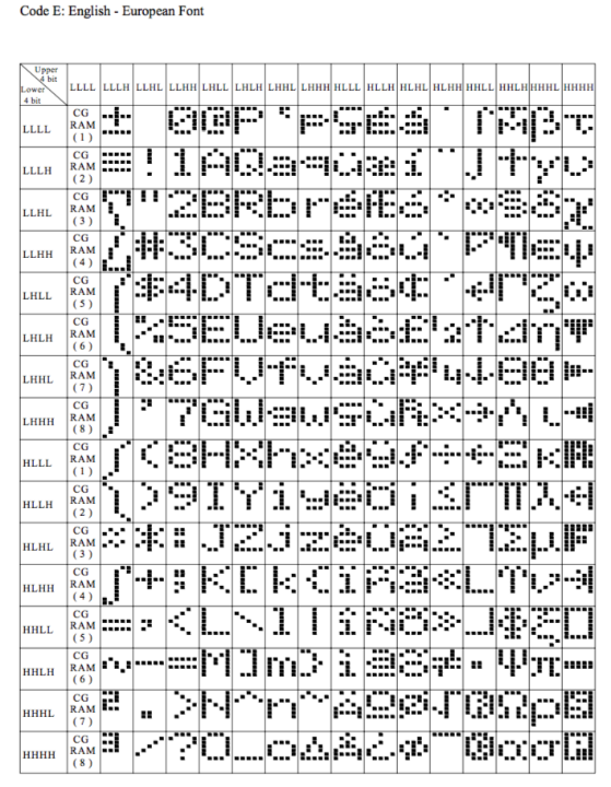

It's not as simple as it looks. The first problem is the display itself. It' containing built-in charater set. Until today, I've seen three types:
Code J.png (319.6 KiB) Viewed 5916 times
Code E.png (309 KiB) Viewed 5916 times
Code C.png (305.89 KiB) Viewed 5916 times
Let's see Code E table, "É" character (top row, around middle). The datasheet says, binary code is HHLL LLLL = 0b11000000 = 192. In the ASCII table (http://www.asciitable.com/), it's 144. My computer say, it's 201. What is the problem? It's the character encoding (https://www.w3.org/International/questi ... s-encoding). This is the second problem.
Flowcode command to the LCD display:
Print String "É".
What will I see on the display? If Flowcode recognizes my "É" as ASCII 201, the display will show me a corner (201 = 0b11001001 = HHLL HLLH). If I have Code J display, I will see some kind of character, similar to J. What if Flowcode and/or Windows recognizes it as a different ASCII code and I have Code C type of display?
