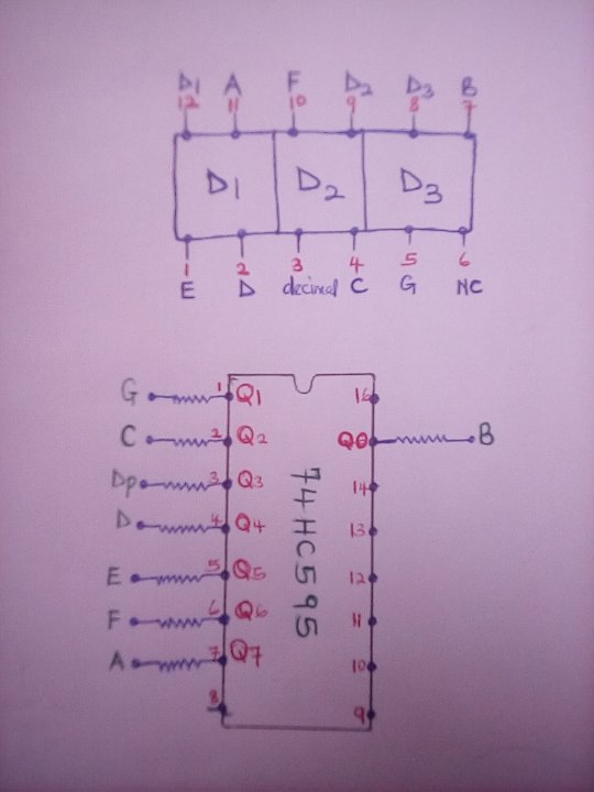

Re: Shift Register 74HC595
[quote="Attached is the file converted to V7/V8.[/quote]
Hi Martin according to your flowchat, for me to understand this easily suppose i have arranged my output like in the image below and i want to display a 5 on digit 1 (D1), then a 7 on digit 2 (D2) and a 8 on digit 3 (D3) how will the flowchat be like for an output arrangement like below?
- 74HC595 Image.jpg (102.27 KiB) Viewed 7512 times
Ok this is how i understand your program Martin correct me if am wrong. You are shifting bits one at a time into the shift register in response to a clock pulse of 1ms and after you have pushed all the 8 bits into the shift register, you jump out of the loop and you latch all the content of the shift register into the storage register which also appears on the output in parallel right? , My problem is the "theory is all over my head ringing bells all the time" Yet the practical bit of it is not yet there.Ok lets do some practical for me to get this into my little head so fast.Please help me take the flowchat below and add the 595 but with an output setting as the picture i provided above its a prog reading voltage from 0 - 55v with that example i believe i will get this in my head in a blink of an eye thanks to all of you guys, learning new things is intresting.
Hello Derrihj,
Q0 - A
Q1 - B
Q2 - C
Q3 - D
Q4 - E
Q5 - F
Q6 - G
Q7 - DP
However one of the problems mentioned by Jorgen seems to suggest this might not work for his hardware and so I might have to add a way of remapping the segments on the shift register. I take it you wired in the way you did to make the wiring easier, say on a single layer PCB?
If you're using Martins example instead of the component then you can simply re-order the segment bit patterns as required.
At the moment the new component assumes that you have wired in a certain way.Hi Martin according to your flowchat, for me to understand this easily suppose i have arranged my output like in the image below and i want to display a 5 on digit 1 (D1), then a 7 on digit 2 (D2) and a 8 on digit 3 (D3) how will the flowchat be like for an output arrangement like below?
