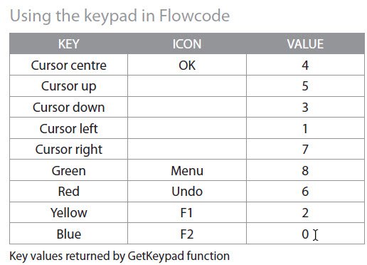

From the MIAC for Pic manual there is a nice table that shows the numbers returned from the keypad
as shown below
In the dsPIC manual there is no such information is there some info you can help me with
Thanks a million

Sorry for the omission.
It's the same for V3 MIACs, dsPIC etc.
Leigh
