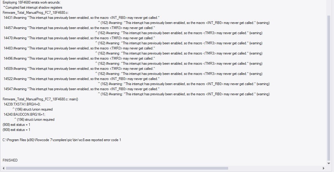

I tried to add the C code (4 lines you mentioned) but i get an error(see attachment).
I am using 19.660800 Mhz Crystal and i want to set the baud rate value at 1200.
As far as i read in the manual i can only calculate the value of SPBRG. The formula i used for getting the SPBRG value is :
((FOSC/Desired Baud Rate)/64) – 1 = ((19660800/1200)/64)-1 = 255
I can't understand how to calculate the value for SPBRGH.
If you can give me a hand here i will be more than thankful.
George

Re: Low Baud Rate speeds- How to set up using C code
Hi George
Can you post your program?
I guess I forgot something... bits
TXSTAbits.BRGH=0;
BAUDCONbits.BRG16=0;
For some baudrate you need a 16bit value. In a 8bit Pic you need two register for this value.
You can choose if you just use a 8 bit Value (in SPBRG)
If you set the bit BAUDCONbits.BRG16=0 you don't have to care about SPBRGH (H is for higher byte)
BRG16: 16-bit Baud Rate Register Enable bit
1 = 16-bit Baud Rate Generator – SPBRGH and SPBRG
0 = 8-bit Baud Rate Generator – SPBRG only (Compatible mode), SPBRGH value ignored

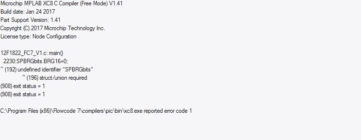

I am trying to set the same baud rate value on a 16F88 device but i am getting an error for the C code.
Should i use any other code than this i used for 18F device?
George

Hi Georg
Yes, something like this:
TXSTAbits.BRGH=0;
SPBRGbits.BRG16=0;
SPBRGH=0;
SPBRG=32;
https://docs.rs-online.com/a168/0900766b81382af8.pdf

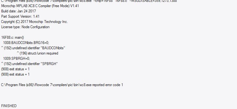

Hi Stafan, thank you once again for helping me out.
I got this error after compiling with the code you provided.
I am looking the datasheet so i can familiarise myself and learn about it.
George

Hi George,
How about
Posts: 654
Location: switzerland
Has thanked: 182 times
Been thanked: 179 times
Hi Martin
Thanks a lot
I think you are right;
TXSTAbits.BRGH=0;
SPBRGH=0;
SPBRG=32;

medelec35 wrote: ↑
Tue Feb 09, 2021 8:36 pm
Hi George,
How about
Hi Martin and Stefan
no luck with this code, i am getting error on C code again. :(
Posts: 654
Hi George
remove BAUDCONbits.BRG16=0; // You don't need it necessarily.
just
TXSTAbits.BRGH=0;
SPBRG=32
George_B

worked fine!
Thanks Again Stefan, i hope one day i can "payback" this to all you guys.
