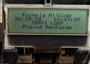

2) The flowchart sent to target, locks the buggy up with:
Buggy locked up.png (155.64 KiB) Viewed 11691 times
The time when picure of LCD was taken is 21:23 and flowchart was sent at 16:43. the battery is on 98% but wrongly showing low.
Backlight is permanently off.
My only option is to upload factory settings, to get display to work normally.
Attached flowchart was to test one random function.
Buggy was initially loaded with API_Master_Production - P4v3.hex
All code buggy test1.fcfx
(7.68 KiB) Downloaded 365 times

PWM problem should be resolved now, investigating the Formula AllCode lockup issue, It is designed not to let you proceed if the battery is too low but if it's a false positive reading then I'll try and see why this is happening.

Yes, it's a false positive as when restored with factory firmware,
the LCD lit again and battery went back up to 98%.

@Benj Did you discover the solution to this issue?
I am using the formula allcode with a maze running algorithm on flowcode 8 and encountering the same false low battery halting on a fully charged rover.
Was it a specific macro or initialisation sequence that caused or resolved it?
tia
Andrew
