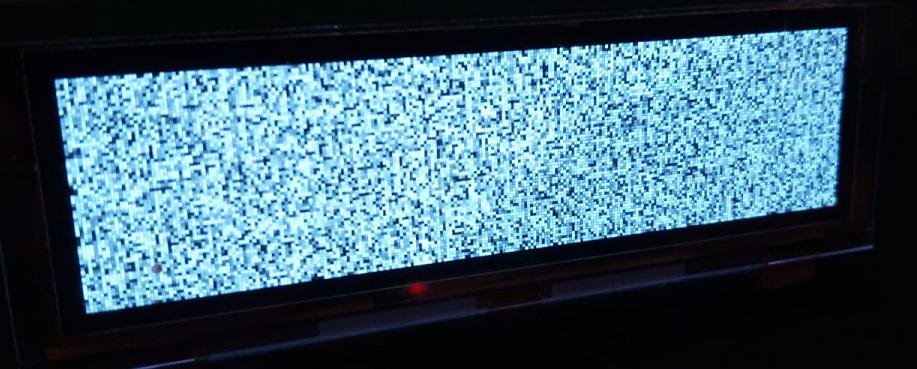

Hi guys,
Flowcode 8.2.2 (latest version). We are using an SSD1322 in parallel mode (Interface Type: 8080) with a PIC32MZ. When I try to initialize the display, it just shows rubbish on the screen :-(
We are sure the PIC32MZ is running at correct speed and not crashing as we have a second LCD display SSD1306 in Buffer mode (serial) alongside working perfectly well.
Where can we start troubleshooting this problem? Would be possible at all to get the FC8 source of the SSD1322 to make sure the timings are correct? The module we are using is from Buydisplay.com, same source we got the SSD1306 which is workng very well.

OK commands didn't make any difference.
Seems that when I enable the display with command 0xAF then the noise shows.
I have asked the supplier to help with what could be wrong here, so might take some time before I get any news about this one.

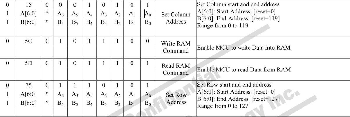

It's strange, it still doesn't work. With the component source, I did expose the WirteCommand and WriteData functions so I could play with those from the FC8 propram.
I can send a command followed by data to the display and works fine, for example set brightness level. But I'm not sure how to write data to the dispay.
I have noticed the Write RAM Command (5Ch). But I'm not sure how to use it either... (After entering this single byte command, data entries will be written into the display RAM until another command is written. Address pointer is increased accordingly. This command must be sent before write data into RAM).
I have not found this command in the component source, so I'm lost as to how to implement it...
Many thanks again for your help,
R

One more thing, the contact from BuyDisplay gave me a quick example routine to clear the display as follows.
void Clear_ram()
{ unsigned char x,y;
 Write_Instruction(0x15);
 Write_Data(0x00);
 Write_Data(0x77);
 Write_Instruction(0x75);
 Write_Data(0x00);
 Write_Data(0x7f);
 Write_Instruction(0x5C);
 for(y=0;y<128;y++)
  { for(x=0;x<120;x++)
   {   Write_Data(0x00);
