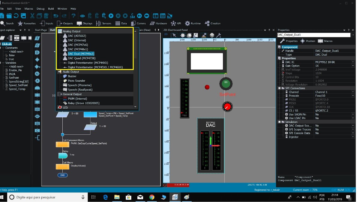

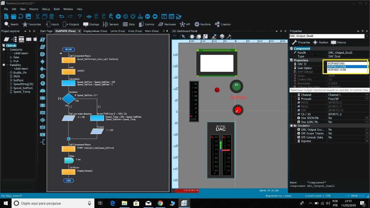

Re: Component for MCP47X6, MCP44XX,45XX,46XX Family,
Hi Benj, I updated the system but couldnt find the component mcp4921 available to use. I uploaded a picture of the screen.
Rod
Rod
- MCP.jpg (120.27 KiB) Viewed 35267 times
- Mcp - Pic2.jpg (124.22 KiB) Viewed 35267 times
Hi Rod,
I've added a new component so you will need to do a full database update and then replace the MCP49x2 component on your panel with the new MCP49x1 component.
In Flowcode v8 onwards there are many MCP DACs including the MCP4921 component under Outputs. Very handy to have.
Hello! Bachman and Chipfryer27
good evening
The explanation you gave in your previous post is indeed very helpful to understand how it works, and as mentioned by Chipfryer27 the component is read available in the FC8 and yes it is very easy to use, actually i made a mistake in one of the settings in the properties window about Prescale, while testing i found the correct setting and the component worked as expected.
Once again many many thanks to both of you for your answer/explanation.
Abhi
good evening
Abhi
