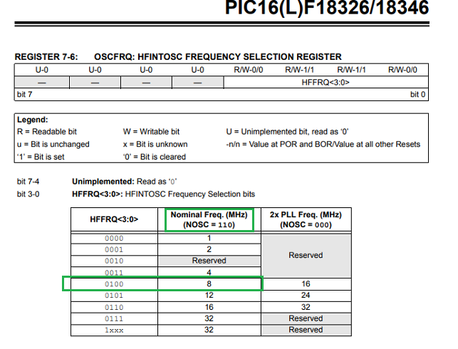

Hi Frank,
Unfortunately, Microchip decided to change the name of the register from OSCCON to OSCFRQ
So the OSCCON part requires removing.
Now what you need to do is within the configuration settings is select HFINTOSC32MHz
The C block at the start requires a value for OSCFRQ which is found within the datasheet on page 93:
16F18346 Datasheet.png (114.05 KiB) Viewed 1667 times
The frequency selected can be from 1 to 32MHz.
So as you want 8MHz you can see that the value is 0100.
Since that it's 4 you can use hex:
OSCFRQ = 0x4;
or decimal:
OSCFRQ = 4;
or even binary:
OSCFRQ = 0b0100
It's vital that you check by using a one-second flasher test to make sure the mico is running at the correct speed.
