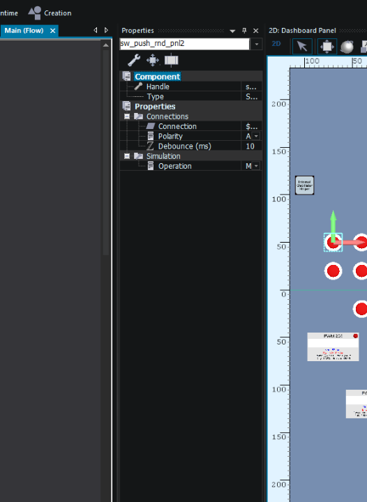

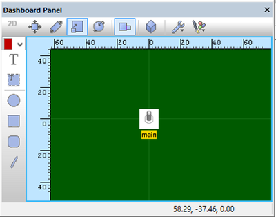

This is probably a really stupid question but how do you add text to the panel - I have searched and found references to a toolbox on the left of the panel but my flowcode does not have it and I cannot find a way of turning it on, I have attached screenshots of my flowcode and what I found on the internet.
Ben

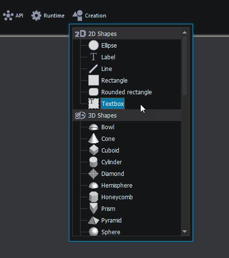

If i have not mistaken you want to label your components in the panel, then as per FC8, label is available in
Creation ----> 2D Shapes (Label)
or else in "Component Search" type Label, after placing it in the panel you can edit as per your need.
Abhi

Or here :-)
EDIT: AbhijitR allready had answered this.
