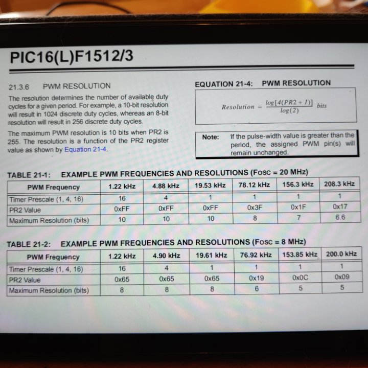

The PIC documentation gives the following on 'PWM 'resolution
(sorry had to photo the page here - for better reading download from microchip.com)

Thanks for the reply, ive experimented with 4, 8, 16 and 20 MHz clocks but didnt notice any difference in results even though by the data sheet saying 10 bit on the highest frequency (20 meg) as opposed the 8 MHz in your picture

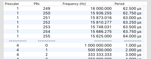

I did this: (a while ago)
freq2.fcfx
(16.96 KiB) Downloaded 510 times
That did a frequency sweep (on a pic16lf1513) and the output looked good on a scope... Approx 15Hz steps.

For example, let's see the datasheet of PIC12F1840.
The PWM frequency is based on Timer2 settings (prescaler + PR2 values) and Fosc. The frequency is not is linearly related to the PR2 value. For equation, see datasheet. You can't say, one step in PR2 equals n Hertz.
As you see, not every frequencies can be generated by a simple PWM generator and you can't create fixed step values. The precision of the PWM frequency is based on the precision of the oscillator.
Don't mix the frequency with the duty cycle ratio. PWM resolution = Duty cycle ratio resolution. You can get 10 bits if PR2=255. If PR2=63, the resolution is 8 bits. If PR2=0 you get 2 bits resolution and this means, you can generate 0, 25, 50, 75 and 100 % duty cycle ratio, no intermediate steps. For equation, check datasheet or use online PWM calculator.
