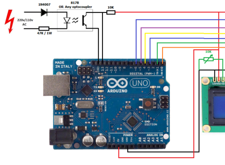

Re: AC mains Hz meter
I have created a flowchart by copying the code from the link Jorgen provided.
The LCD pins will need changing for your hardware.
I would not use D0 or D1 If I was you as they are used if UART is required e.g diagnostics, extra data etc.
I have not tested on hardware, so I have no guarantees it will work.
The trimmer looks like it's not wired correctly.
You will need the supply VDD and GND going to the outer ends of the trimmer and the middle wiper goes to VEE of the display.
The optocoupler must be connected to INT0 which is digital pin 2.
I would probably use two 68K resistors in series, instead of a single 47K resistor.
The optocoupler I would choose would be one with the highest CTR value that's reasonably priced.
Just make sure it is a reputable make as that is what is isolating the dangerous mains from the SELV side of the Arduino.

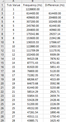

The maximum frequency is not as easy to answer.
The formula use for frequency is
So the lower the ticks then the higher the frequency, but then has the less resolution.
For example with a few tick values: Although the highest frequency for when the tick is just 1 = 1.2MHz, when the tick is 2 the frequency will need to be 614KHz.
This is not practical for a frequency meter.
It depends on the resolution required.
If the max resolution is 500Hz or less then the maximum frequency will be just under 25KHz

If you look at the formula
Frequency = (19660800.0 / 4.0 / 2.0) / FLOAT valueNow the frequency is known, the period in seconds = 1/frequency.
The period is then x 1000 to get period in ms

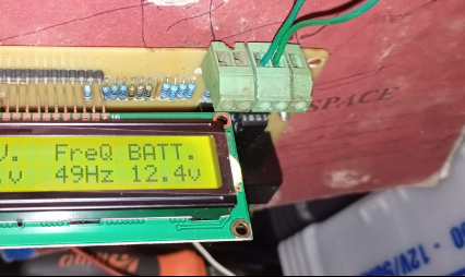

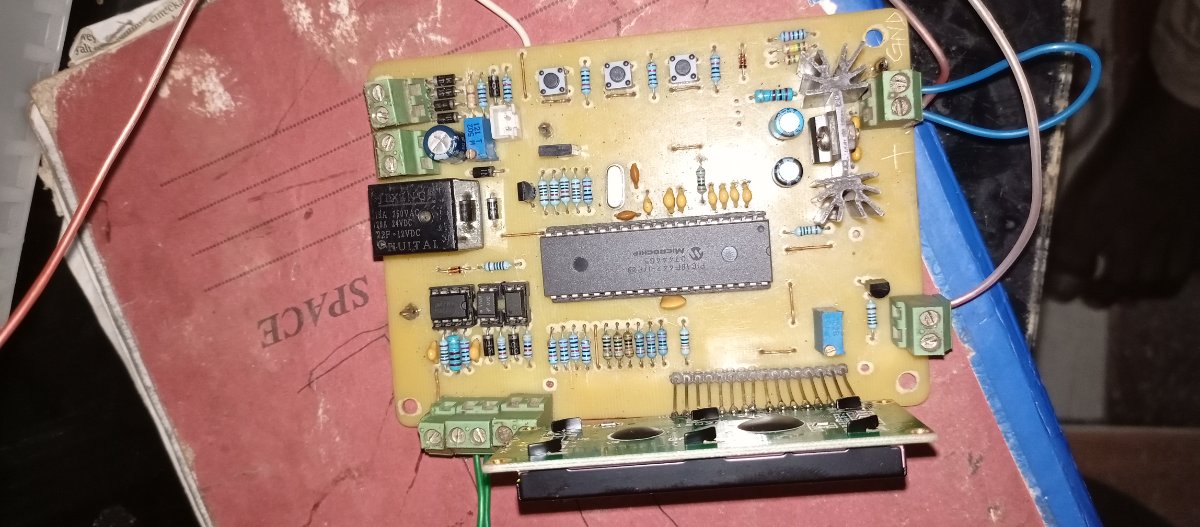

Like i said, that i will build this and test it when i get back so i had to do this really fast, at the moment the PCB is not the best but the frequency meter works really well thanks Martin and the rest, guys peace. Oh one more thing, I really need help guys with the flowchart on the link below:. viewtopic.php?f=76&t=21441
