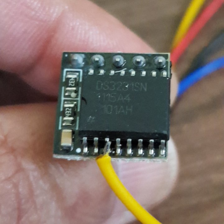

Hello! Martin
Humbly thank you for your valuable input, your suggestion worked like a "Piece of Cake".
As you instructed i manage to take the pin 3 of the chip to one of the interrupt pin on my chip, the RTC was already powered, i configured the SQWandINTcontrol Macro at the beginning of the main loop and done, i can see the LED placed in the INT macro flashing every sec, i had a very big smile on my face,
like that.
Thank you once again for your quick reply.
Abhi

Hi! Martin
Not only the LED blink every second my calculation box now calculate the average exactly after 1 minute without fail.
And regarding the soldering to the pin 3, it was not a big trouble.
Cheers Martin, have a pleasant evening.
Abhi
