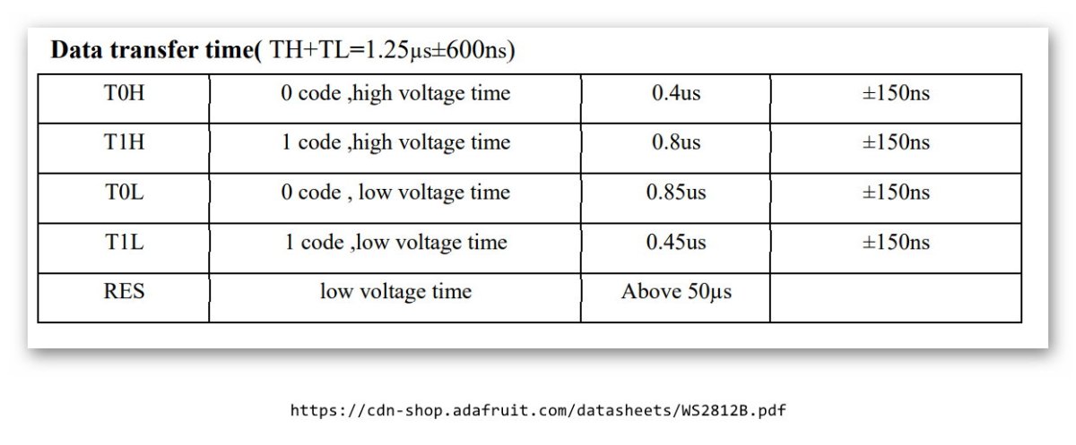

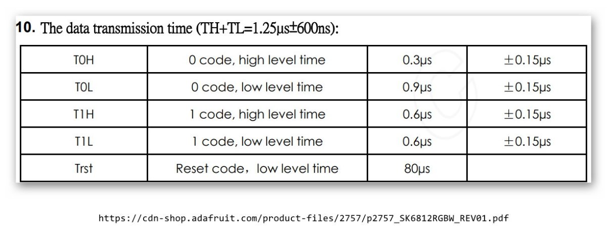

And a datasheet (which seems to show the layout as RGBW) https://cdn-shop.adafruit.com/product-f ... _REV01.pdf
To confuse the issue - they are also available in RGB form - which accept 24 bit colour (GRB as per ws2812) https://cdn-shop.adafruit.com/product-f ... sheet+.pdf
The timings required are also different to WS2812 - (for example reset time is 80us instead of 50us) Guess I was lucky that it worked last night....
