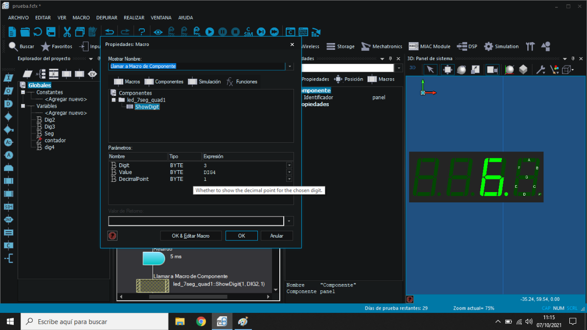

2º.- On the other hand I have problems with the visualization of the decimal point. I attach an image capture of the macro display properties where: the first parameter is the digit to display the value, the second parameter is the value itself and the third parameter is the one that commands the decimal point to turn on.
Being a common cathode display, if I set it to 1, the decimal point lights up. Right, this in the simulator works fine, perfect.
But in the actual montage what I observe is that the decimal points of the first and second digits are dimly lit and blinking.
