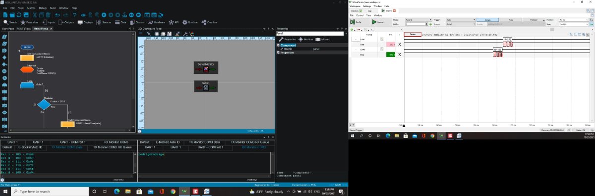

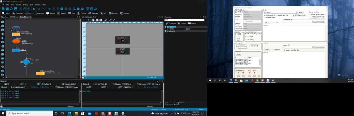

Hi everyone, by studying the examples in the wiki and the various components available, iam trying to simulate and download in hardware a simple example of echo, so I can move on to my project. Iam trying to code by using the component UART flowcode 8, and in hardware USB-UART and iam not getting good results.
Can somebody run tests for me please. I have the easyic and the easypic pro, it could be pic18F45k22, pic18F87j50 or 87k22.

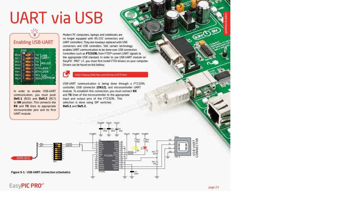

The USB-Uart circuit schematic uses the FT232RL.
Rod
USB UART - Test.jpg (71.75 KiB) Viewed 13847 times
USB UART - Pic.jpg (109.89 KiB) Viewed 13847 times

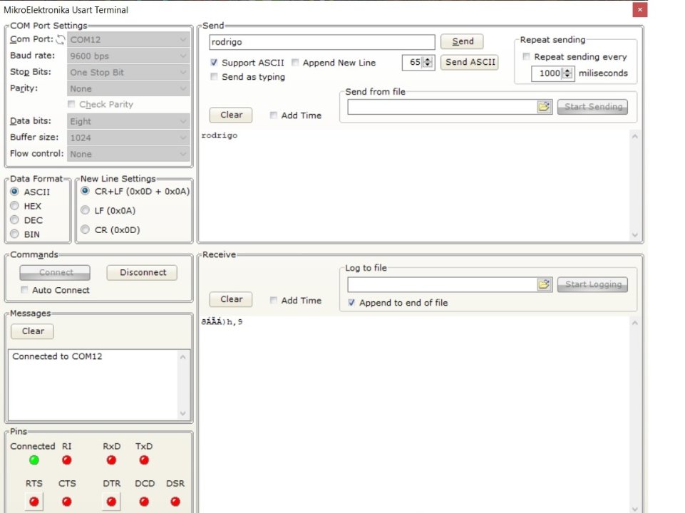

Hi Medelec, thnx for replying. The result remains the same. Strange.
Rod

Re: UART Component - USB-UART FT232RL hardware
Seems like hardware or UART might not be running at the correct speed?
Do you have a logic analyser or an oscilloscope?
If not have you made sure the one second flasher is running at the correct rate?

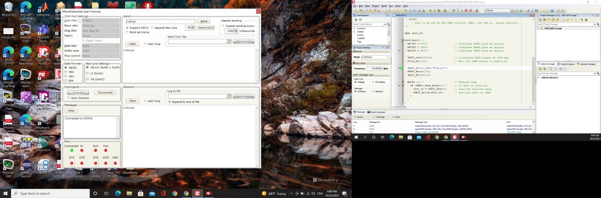

Hi Medlec Ive just ran a test with a hello world from mikroe's echo example
It is working fine.
Yes, that suggests that Mikroe is controlling everything at the correct speed.
Flowcode may not, e.g. could be a configuration issue so the clock speed is wrong.
Or clock speed is correct and UART might be working at the wrong baud rate.
That's why I have asked about the one sec flash test and if you had a logic analyser or an oscilloscope.

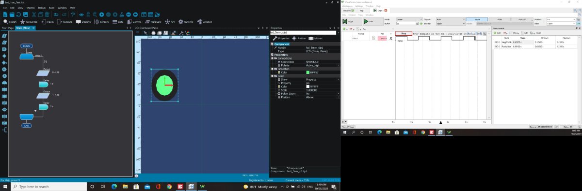

Hi Medelc, here is the 1sec flasher. It seems right.
Thnx
Rod
1sec flasher.jpg (53.09 KiB) Viewed 13821 times

You are showing me the simulation, did you time the on /off times on your easypic pro?

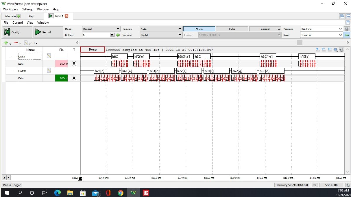

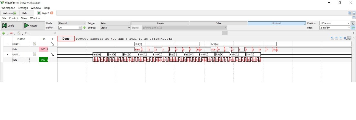

Hi Medelec, I ran the tests using the another board easypic with pic18F45K22. The error remains the same as you can see by the pictures.
I was able to stablish comm with flowcode and the board but the data tx is not echoing the same message on the rx.
what is the next step?
Thanks again
Rod
Logic analyser.jpg (56.62 KiB) Viewed 13783 times

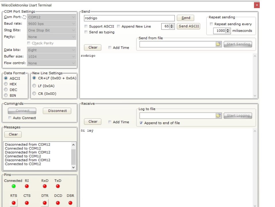

Hi Medelec, Ive just ran a test by changing the oscillator config to the same hello world from mikroe and it worked perfectly. I was able to stablish comm from flowcode to mikroe easy pic board. I wrote my name and tx and rx were the same messages that were trade between them and the logic analyser confirmed. One observation though, is that hexadecimal code generated was from the mikroe compiler and not from the flowcode compiler.
I tried to test again by coding using flowocode and the error remains.
So what now?
Thanks for the help
Rod
Test worked.jpg (60.58 KiB) Viewed 13782 times

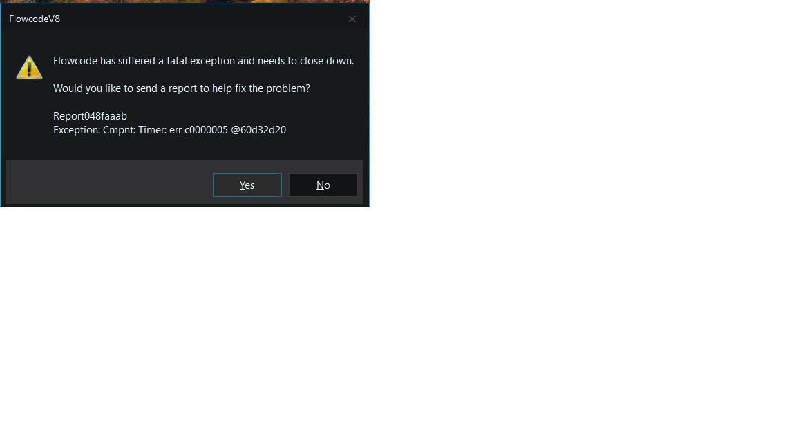

Hi Medelec im getting error attached
thnx
Rod
error message.jpg (27.83 KiB) Viewed 13779 times

Looking at the image of the analyser the UART is way too slow.
Can you do two things.
1. Run the 1 sec flasher measure the pin on/ off duration. what is the value?
2. I can't see the single UART pulse duration from the image, what is the value?
How often does the crashing occur?
r_teixeir

Hi Medelec I wrote my name as one single hit and i got this.
Rod

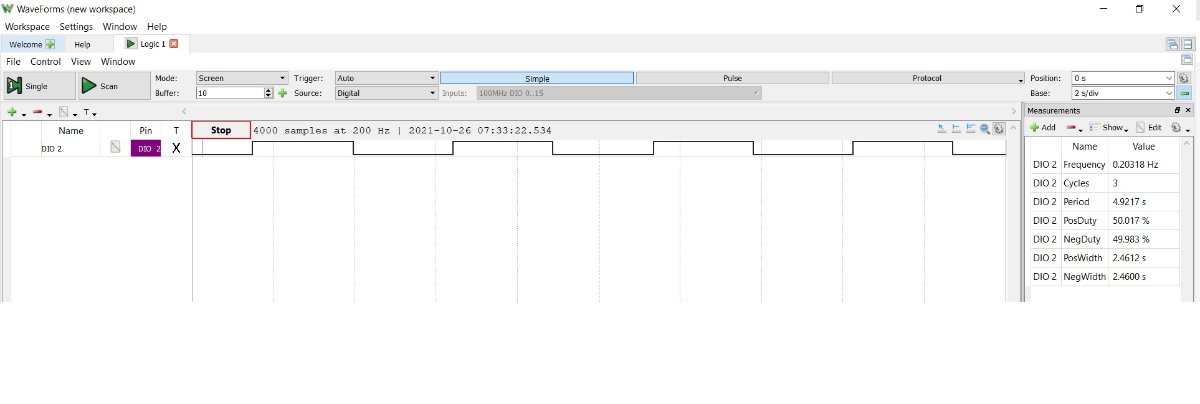

HiMedelec here is the 1sec flasher
thnx
Rod
1sec flasher.jpg (42.6 KiB) Viewed 13760 times
Posts: 9521
Has thanked: 2585 times
Been thanked: 3815 times

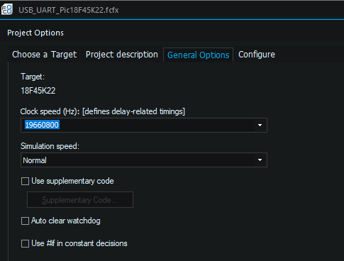

That instantly tells me the configuration of your flowchart does not match your hardware settings.
I have looked at a circuit for Easypic Pro and it has a crystal of 16MHz.
That means you run the microcontroller at either 16 (With PLL disabled) or 64MHz (With PLL enabled).
When I looked at your flowchart it was set at 19660800Hz which is a mismatch.
Try changing the Clock speed within Project options to 16000000 then do another flash test.
If the pulse is then 1 sec then try the UART again.
If it does not work then can you post the generated .c file please?

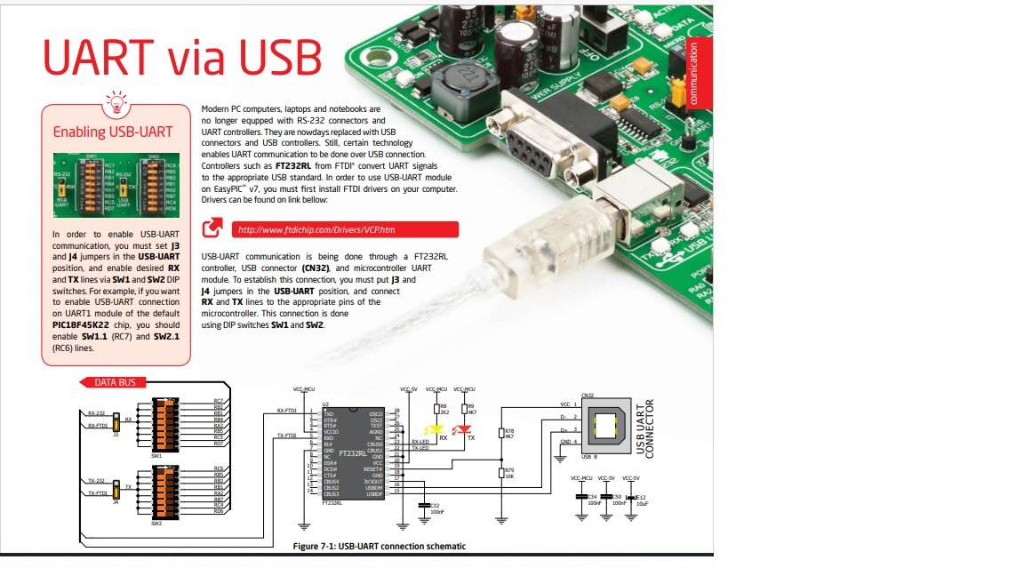

Medelec I appologize i didnt mention before. With these last tests I was running the programs with the easypic board 8Mhz clock and Pic18F45K22.
With this option does it match with your observation?
EasypicBoard Uart via USB.jpg (130.44 KiB) Viewed 13748 times

You will need to make sure the Flowcode Clock setting match the value of the crystal on your board.
If crystal is running at 8MHz ,then you need to change the clock from 19660800 to 8000000.
Both configuration settings of Mikroe and Flowcode should be the same.
The image does not show the crystal for the microcontroller.
If you look within the project options you will see the clock speed still does not match!
Configuation settings witin Project options.png (17.4 KiB) Viewed 13746 times

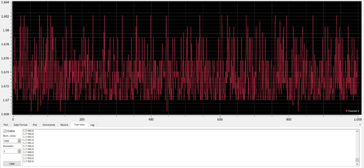

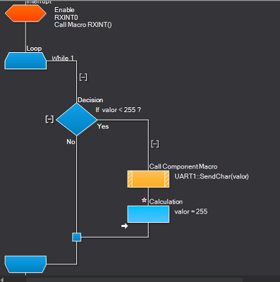

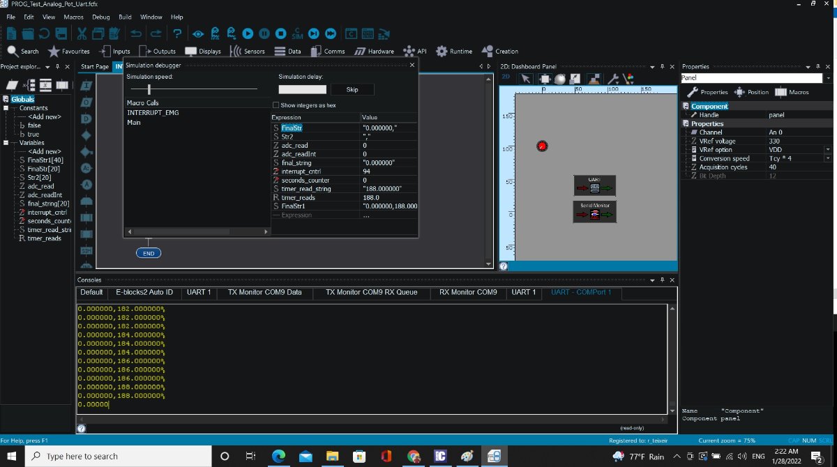

Hi Martin, I changed the interrupt macro to the same way you've mentioned. Thanks for the tip. On the other side, Iam uploading two pics so you can check a problem that iam facing. Iam getting data using a third party uart by changing the anlog values on hardware, but while I use the flowcode Im not able to. Ive ran so many tests and I cant get the analog sent through uart using flowcode and BL0032, only by simulation not on hardware. I tested with, human interface, serial monitor just the uart component, etc. I did indeed got results of analog changing by using the serial monitor but had to let the connection on the serial monitor "open". I read this in wiki page "The incoming data can be seen on the Flowcode console even when the simulation is not running."
Please advise if Iam doing something wrong.
