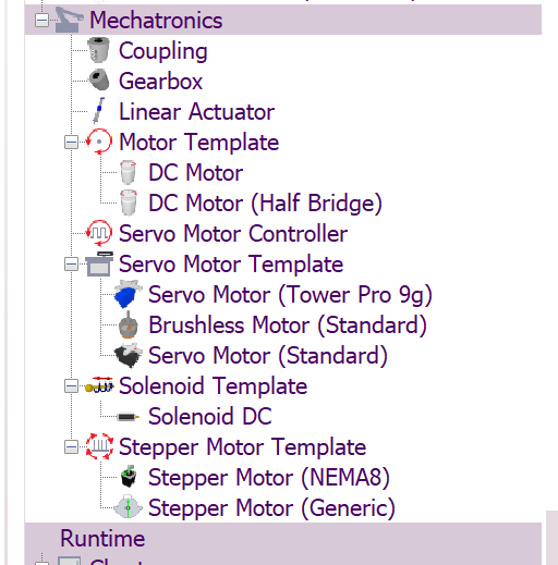

Re: Stepper motor Drivers in flowcode
Thanks very much
All I have are in the attached. I am using v9 though - is there a difference?
Hope I am not being dense
Try using the Stepper Motor (Generic) or the NEMA8. The NEMAxx is really just a reference to the physical size of the motor and the component will probably work for all NEMA motors. The Wiki for these doesn't have an example as yet.
For both, under Properties > Driver you can choose between driving coils directly (via FETs or the like as Matt suggested in an earlier post in the thread) or use Step/Direction to provide signals to a driver board. The latter is probably easier as you can get away with just using Pulse / Direction / Enable pins if application allows.
Many driver board out there catering from hobby to industrial. Which one are you thinking on using?
Hope this helps
Hope this helps
