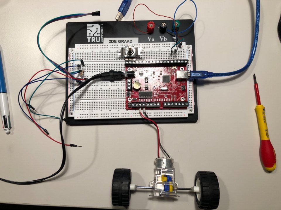

I want to control the speed of the motor with a potentiometer, but the motor always runs at maximum speed, regardless of the position of the slider in the potentiometer. Attached you will find the program I wrote. Can you help me?

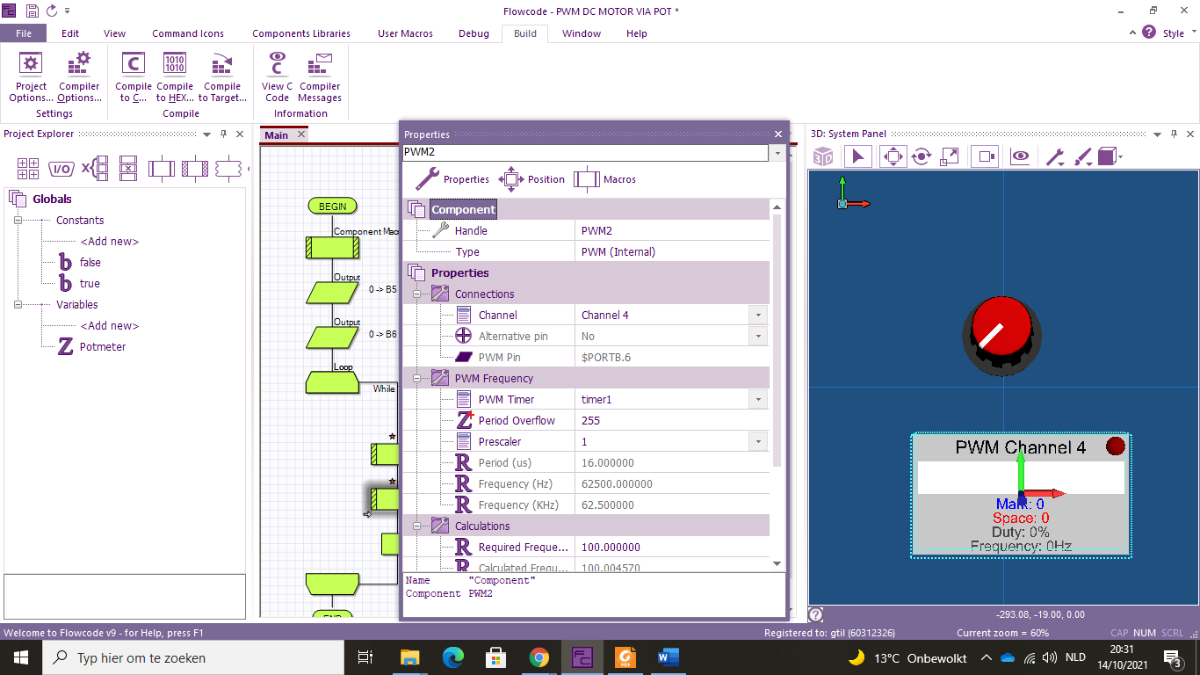

Looking again the PWM component properties there is no value selected for the Timer, maybe ths could be causing a problem?

I have set the timer setting to timer1, but this also does not solve the problem.

This also makes no difference. I use the Brainbox AVR from Bart Huyskens. He is aware of the problem and I have asked him to list the most important things you need from the hardware in function of this problem. Just wait for his answer.

If you are getting pulses at the correct pin then I'm guessing your code is fine and it is something else in the Hardware.
The Brainbox board you are using looks quite interesting and is certainly full of features, although I have no experience with it myself. Have you checked for any "Doh..!" moments? By that I mean have you double checked all connections / jumper settings etc?
The picture isn't too clear so I can't really see what your jumpers are. Have you verified that Jumper 2 is correct? This is the setting for the H-Bridge / PWM power.

Just reread first post so as the motor runs I'm guessing J2 is correct. I think however you might be trying to run the L293D at too high a frequency. From memory I think they prefer much lower values. Does setting the prescaler to 8 or 64 make any difference?
Further edit....
From a few other forums it seems the board likes around 5KHz max. You are running at 62.5KHz. As above, try a prescaler value of 8 or 64 and let us know how you get on.

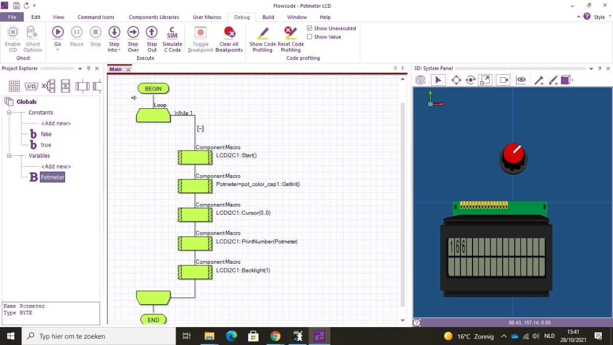

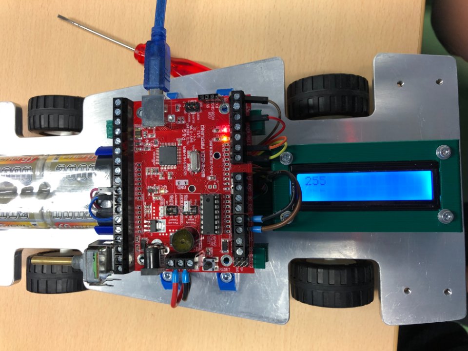

As a test I wrote a program that allows me to write the value of the potentiometer on the LCD. In the simulation of FC itself this works perfectly, but when I download this to my Brainbox AVR. The output remains high (255)independent of the position of the potentiometer.

Re: PWM Control for elektrical motor with potentiometer.
Hi DBMGTIL.
Two things to try.
Within Pot properties, Change Vref option to AVCC
See if that works first.
If that does not work what happens when you set PWM with a value of 127?
Two things to try.
Finally it works! Thanks for your good advice,If I have any problem in the future I know where to find you.
