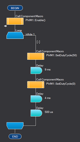

This is c code
// Send 9ms burst
pwm_on();
delay_ms(9);
// Send 4.5ms space
pwm_off();
delay_us(4500);
How can i do this in flowcode?. Desiable pwm component madule for 9ms and enable it again or there is another way??

You can set the duty to 0 for PWM off.
No need to disable then:
PWM Burst.png (45.39 KiB) Viewed 20080 times

Re: How to do Pwm off and on in flowcode??
Post by kg300 »
medelec35 wrote: ↑
Wed Dec 15, 2021 3:54 pm
Thanks :D
You're welcome.
It has been found that with some devices that PWM duty does not completely go to 0.
If that is the same as your target device, then Disable and Enable will be required.
Hopefully, that is not the case, but I thought I would make you aware of a possibility.
