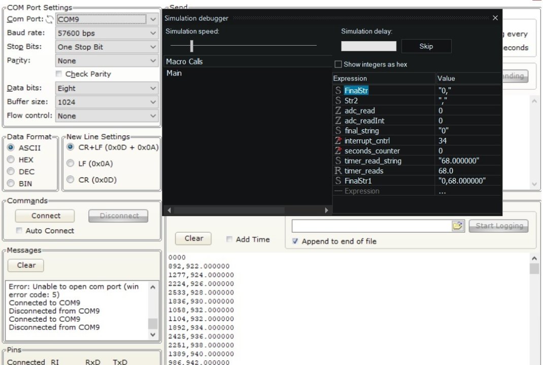

Hi Martin thanks for replying. I corrected the place for the interrupt icon and it solved the problem about displaying values timer string. The problem now is that, the values for time string dont match what show on the simulation. I uploaded the the uart values, the analog is working but the timer should show an increment of 3,3ms for each sampling. Do you have any hints?

Hi Martin, I kept the same code for interrupt macro(The modulus) you've mentioned. Where do you insert that code you wrote? In a c code or the calculation flowchart? I tried to modified the code by not using the modulus, but the results in simulations were not what I wanted because it does not increment one of the variables that gives info about when it reaches 1 sec. If you run my code in simulation you'll see the increment from 3.3ms so on and when it reaches 1s you may see the variable incrementing to 1, which is one of the things I want to.

Re: Analog_Pot_Uart
Hi Rod,
For your flowchart to do what you want, It looks like the modulus is the way to go since you have not got any other modulus functions in your flowchart, except for the timer interrupt.
If you did have modulus functions in other user macros, including main, then to avoid corruption, an alternative would be to use: Which is the modulus equivalent.
I the value used is a power of 2 rather than 300, then bit-shifting would make it more efficient.
So, with your flowchart, if the timer interrupt is moved to above the main loop, it should hopefully work the way it's intended to?
