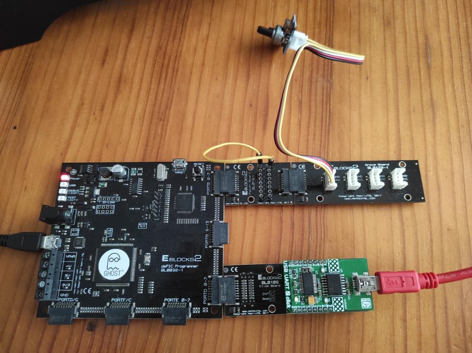

What connection have you got the analogue voltage connected to on your BL0032 & can you measure the voltage with DMM?

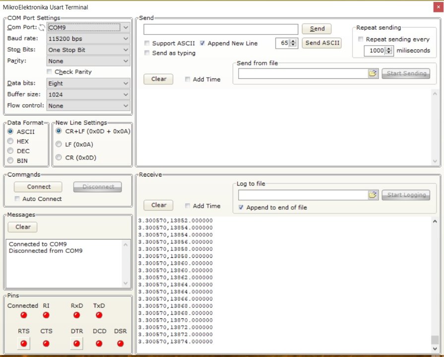

Hi Martin, I dont know If I made myself clear, but what i was trying to explain on my last post is: I cant get the uart comm to read the analog changing while using flowcode.
On the other side, while I use a third party for example mikroe uart, iam able to read the analog changing through Uart.
Thank
