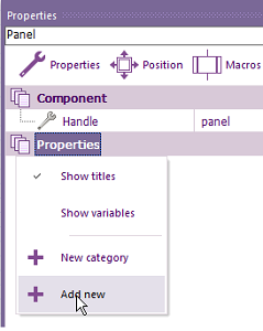

Hi Miguel.
Hover over the lower properties to show a drop-down.
Select Add new
Panel Properties.png (27.5 KiB) Viewed 15994 times
The Cosmetic name will be TEST
You can have spaces within the cosmetic name.
The Property type you can select Single digital pin.
The Property variable can be something like PIC_PORTB_RB2.
Leave Visible, Writable and Generate a define for the property as the defaults.
After Selecting OK, you will need to select the pin that is next to TEST
The TEST is now available to use which will be assigned to your chosen pin.
