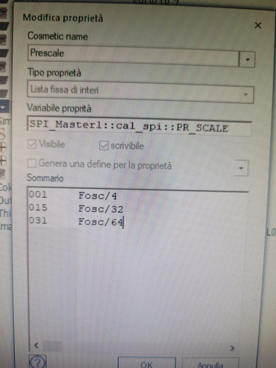

Hi at all
I think I have solved the problem of the "Standard" configuration of the SPI module of the Pic 18Fxx42 series, thanks also to Bachman's suggestion. The only problem is the configuration of the prescaler which has a different setting from the other PICs.
I forced the default values that are set in the SPI configuration mask: for example, the value to pass to the variable PR_SCALE, is 15 to have a x32 division factor, as also shown in the photo.
It would be nice if the FC team modified the PIC_CAL_SPI.c file to add the few instructions.
Below is the C code to add at the beginning of the program.
best regards
Set_SPI_1
SPI1CON2 = 0x03; // 0b00000011
SPI1CLK = 0x00;
SPI1CON0 = 0x83; // 0b10000011
best regards
Set_SPI_1
SPI1CLK = 0x00;
